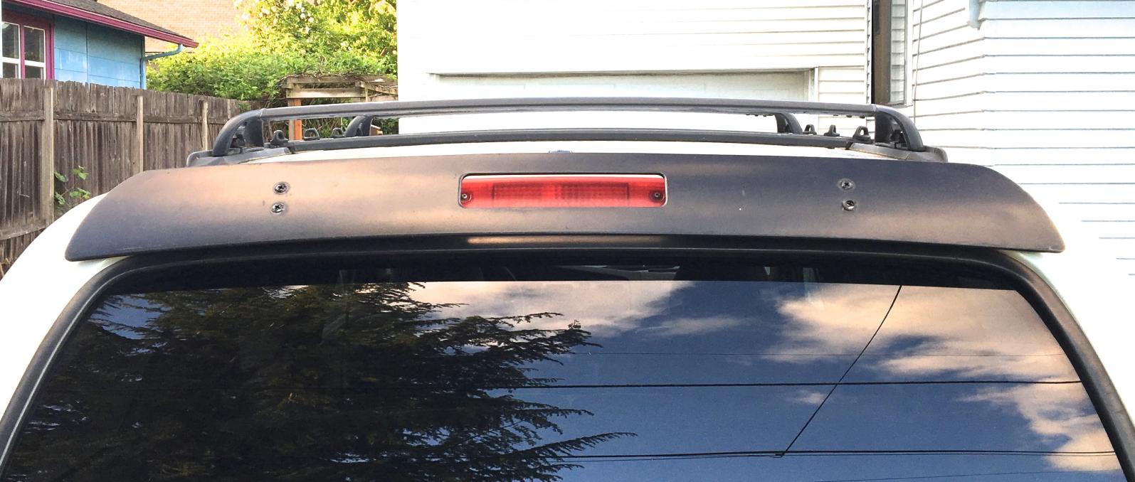

Most likely M6x1.0mm rivnuts will get you there... But they may be smaller.
Here's a pic of the area from the Burtman site:
