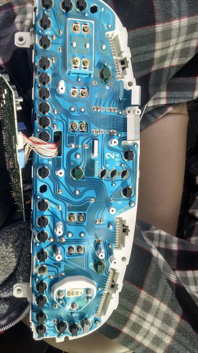

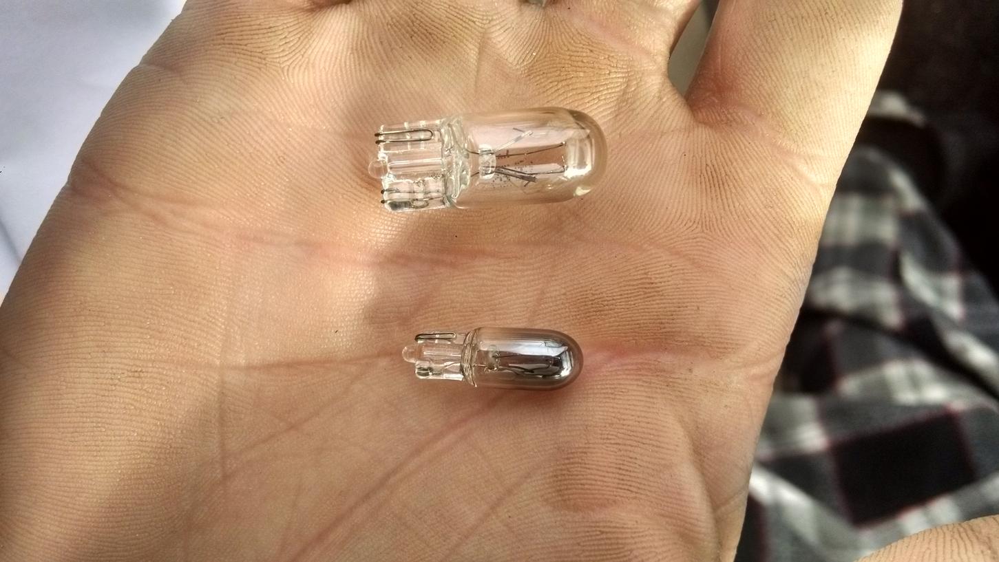

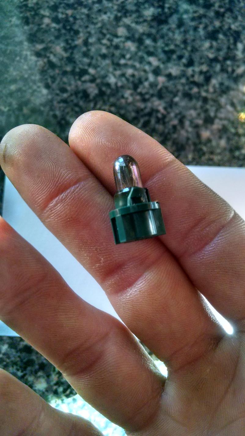

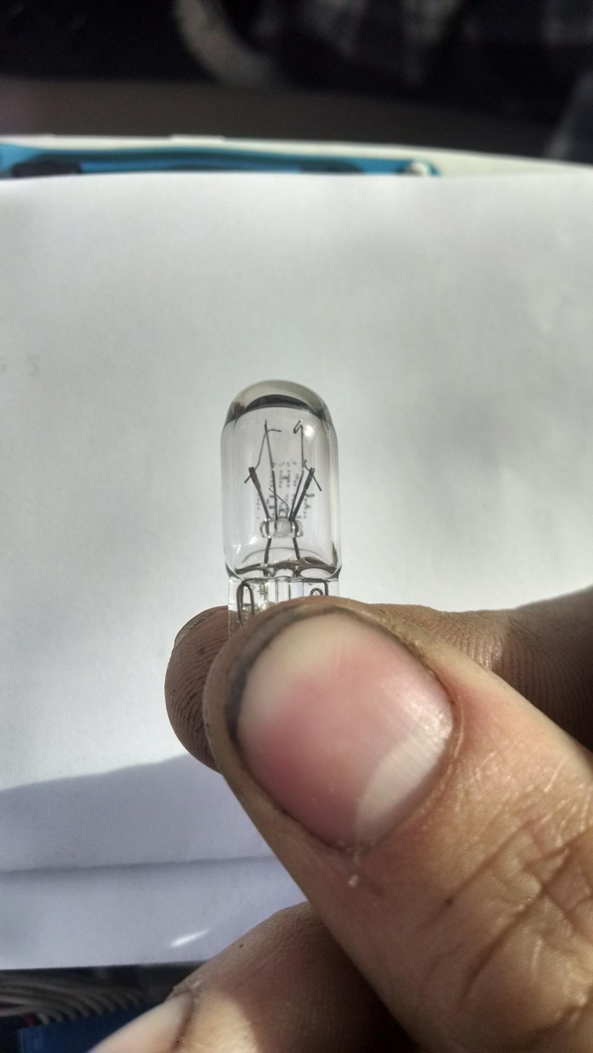

The first pic is the 194 bulb I had bought ..you can barley see the print on the bulb to confirm it is a 194 ...second pic is of the 194 bulb next to the bulb I pulled out of the green housing.....clearly way bigger ...and the third pic is of the back of the cluster which I will say I was wrong on when I said all the build housings were the same size the 3 that are green are just a tad bigger than all the black ones but still is not a 194

That's what I was thinking I would need ....thank you so much for your help and knowledge on the subject ...I have never had good luck when it comes to cars ..I always find one that is just a little different than everyone else's ....I used to own a 1990 celica gt that was the sane way .....it had work done to it to convert it to a 5 speed and made it very hard to put motor mounts on it but again thank you for the help ...can't wait to get these LEDs put in and finally get rid of that ugly green well not green anymore ...while I had the cluster out I scraped that green condom off and I now have an ugly warm white but its so much better than the green ...I also have another issue with my t4r but I'll start a different thread if I can't find any info on it ...has to do with the 4 wheel drive
