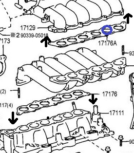

the only stupid question I have is....do these blue rings on the gasket face outward? away from the intake plenum like this:
or the opposite? lol

I would assume they aren't on only one face of the gasket for a reason, but then again I am asking for advice.:wink2:
I'd assume because a gasket's only function is to act as a median between two faces being joined and help achieve a seal - if it can do so as is, doubling up on the material is simply wasting it twice as fast. And in this application both surfaces being joined are a mirror image of one another, and would therefore make zero difference as to which side the blue material is on. Probably stands reason to assume if they went in a certain way then there would be instructions telling you so, since this is a one-time part and failing to include any would surely mean lots of people putting them in backwards and ruining them instantly, and thinking the product is crap as a result since it didn't work. Just the way I see it.

Took me a minute to see what your are talking about. There are blue rings on the surface of the gasket only on one side. Interesting. I have no clue!
I always put the rubber side on whatever side is more rough. Very scientific I know. Put it face up with the rubber upwards on the lower intake manifold though.
I see what you are thinking...I think, the weight from the intake and the vibration of the engine; the rubber rings facing up from the lower intake give the upper intake a cushioned surface to rest on?
Considering the OEM seal is metal I wouldn't worry about which way is up or down
I used felpro when I did my knock sensors and had no issues. ( did use real denso knock sensors and toyota harness) I beleive for the plenuim I went rubber up. I cleaned all surfaces really well. Had no issues or leaks.
Lower intake manifold is rarely removed, so the surface on it is often unmarred. Can't say the same for the plenum, so rubber goes on the plenum.
