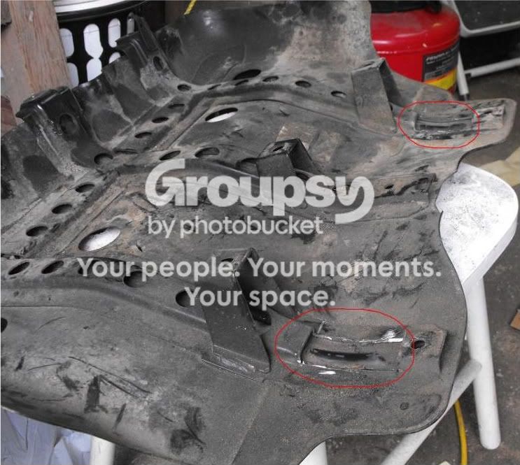

No just the part of the skid plate frame where the differential mount and diff drop bolt hits..
drop.jpg~original
The Toytec 1/2" skid plate spacers go on top of the bolt holes to compensate for that amount of diff drop to eliminate the grinding and trimming I did as on the photo.
Here's the con.
