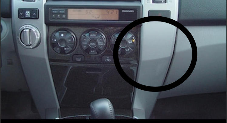

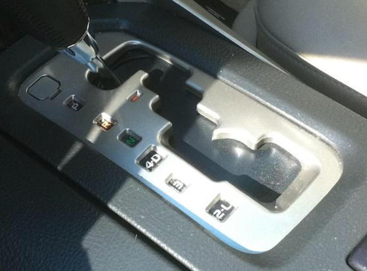

I’ve searched for a long time and I don’t think anyone ever figured out the exact color to touch up scratches in the Grey (Stone??) 4th gen interior.
I found a thread that says “Rustoleum universal (not just for metal) satin nickel“ is a 95% match.
I tried 1D4/Titanium Metallic, and it’s too shiny. Not even close.
I’m wanting to touch up the silver/gray area where the transmission indicators are and the sides of that area, the console. Two large scratches are there.
I can’t vinyl wrap it, I have read that stuff doesn’t work well in cold climates. I’m in Wisconsin, so that’s out.
Has anyone figured it out a touch up code that works?
May have to go to a body shop, as a last resort if not.

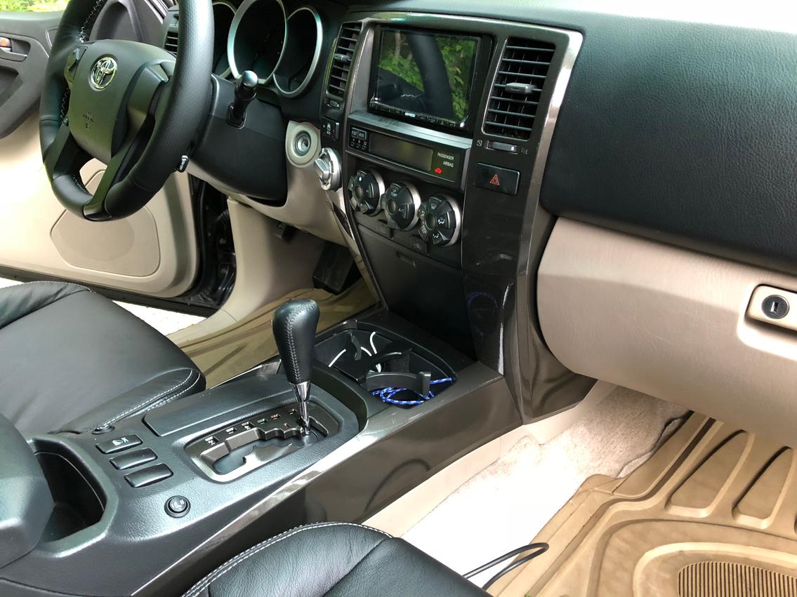

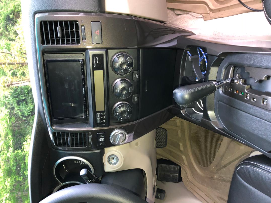

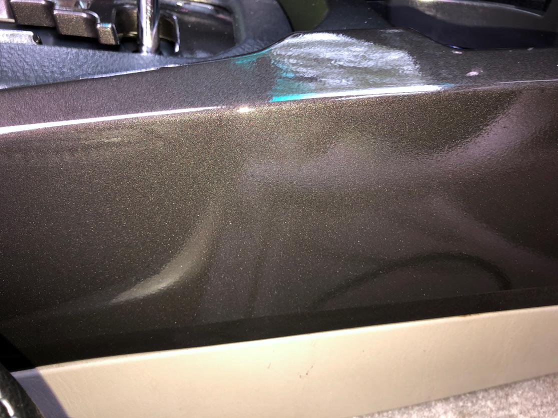

Not sure if you would want to do this but after not being able to find touch up paint for it I ended up just repainting all the trim to match the sport edition. Here were the results. I used a 2K clearcoat in a can, rustoleum Carbon mist metallic.

That looks really good! I have some scratches that really bug me in the silver trim, and was considering just going with a darker charcoal type color, so it’s nice to get a preview of how it would look. Like the OP, I can’t seem to find a good match for the original silver anyway.

Thanks! and that was my issue as well and once I looked closer the paint itself was fading anyway so I went ahead and repainted. Prep is key to a good outcome

You worked your butt off and it looks amazing!

I love what you did, looks Great!
I know very little about painting. What king of prep did you do? Thanks!
Did you wet sand between paint coats and clear coats??
For the prep with the trim I used a soft foam sanding block so I could get in all the corners. Next I wiped everything down with 90 percent isopropyl alcohol then after that was dry sprayed 3 layers of base coat (warmed the can up in hot water) then later went back over everything with three coats of clear. (Also heated up the can) I did not wet sand anything. There is a little orange peel but nothing I am going to worry about haha
