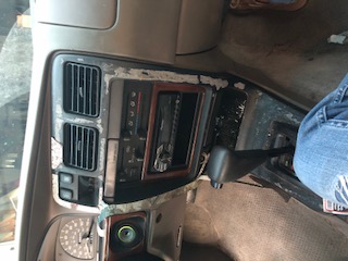

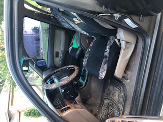

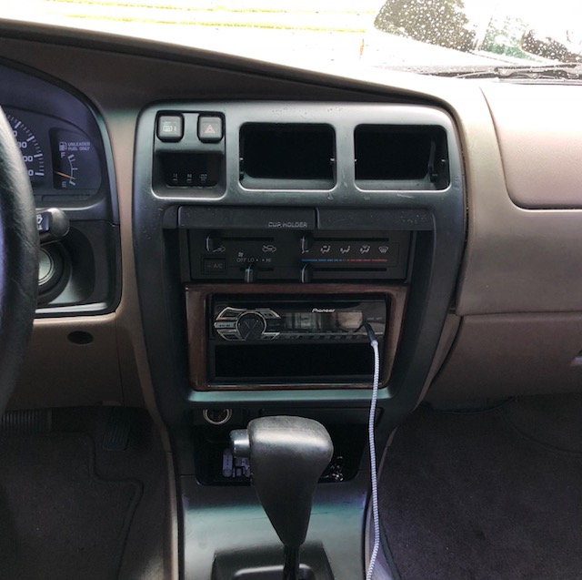

When I bought my T4R the previous owner took some cheap, camo duct tape and "wrapped" basically all of the trim in the interior ON TOP OF the wooden trim manufactured by Toyota. I'm not sure why, but heres the best picture I have of it:
Yeah, I think he liked camo...
So obviously one of the first things I did when I arrived with my new truck was to remove that nasty camo tape, and the fake wood trim underneath to reveal the nice, flat black plastic underneath that looks oh so much better :lol:

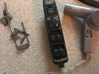

In order to do this you're going to need:
1) Flathead Screwdriver
2) Goo Gone (Or other goo removing product)
3) Heat gun (Hair-dryer is what I used, works well also)
4) Patience
Toyota didn't make this stuff to come off easily, so youre going to need a good 1-3 hours to remove it all.

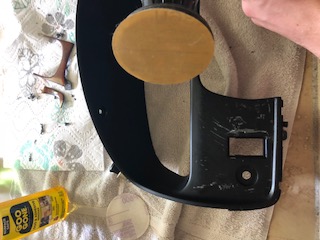

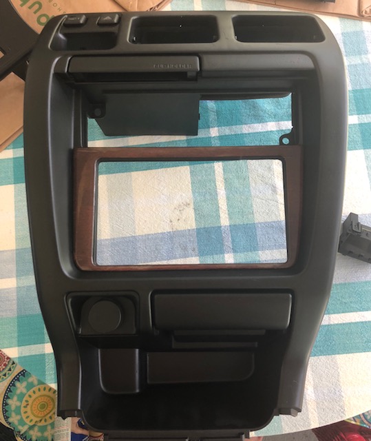

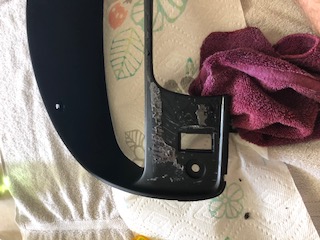

This is what it looked like after I removed all of the duct tape and fake wood trim. All of that gray substance is the glue used to hold the trim onto the plastic... As you can see I didn't do a very good job getting that off with the wood trim, but I also wasn't smart enough to use a heat gun this time around. When you apply the heat you should be able to get that glue off with the trim relatively easily, but if not, that is where the excess amounts of goo-gone and scrubbing come into play. What worked for me was an old washcloth and my fingernail to get under the sticky stuff. :sobbing: :D
At first I had only done the center console because thats where he had put the camo tape, and I left the rest of the wood trim that was left. Recently I decided it was time to do something about it, so I gathered my supplies and went to work:
I took the door panel trim pieces off and removed the trim and glue, and here's what it came out to: (Keep in mind this was probably my most flawless piece)

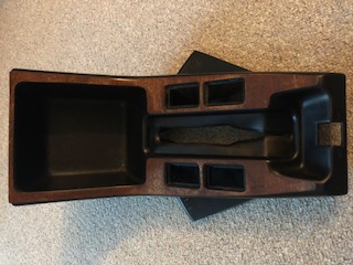

If anyone is curious about what the wood trim looked like before I got it off, here it is:
I also finished up removing the wood and goo from the panel surrounding the instrument cluster, ignition keyhole, and center console.

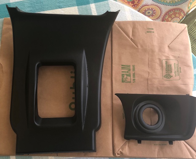

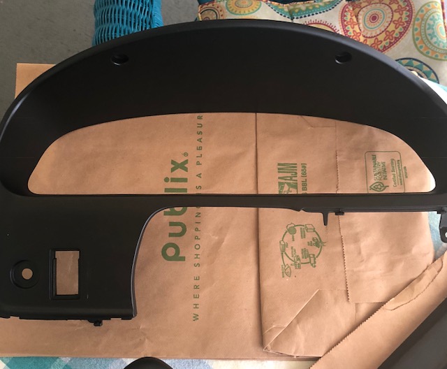

Alright, so it's morning now and the paint has sat overnight. Here are some pictures of the product! I think it turned out pretty good :cheer2:
I know it's not perfect but it makes a big difference to me!
Once I get it all back together in the truck I'll send a few more pics this way :high5:

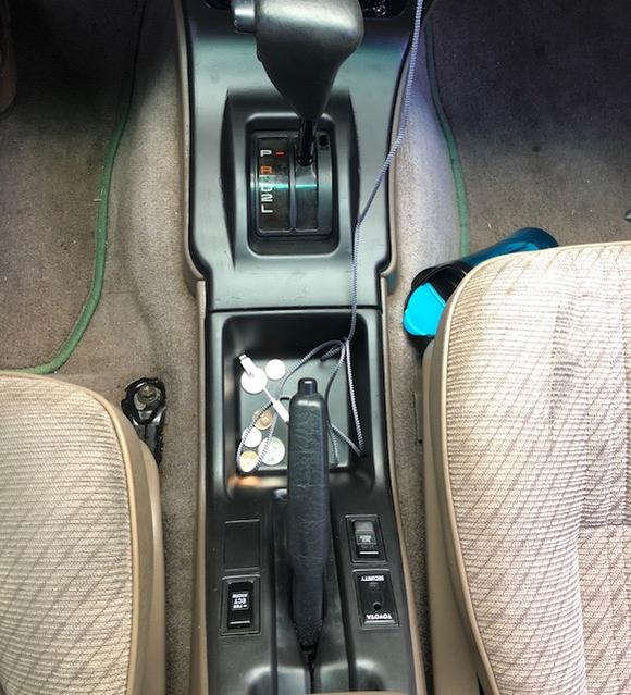

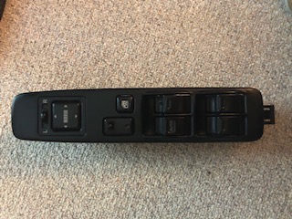

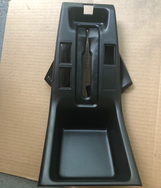

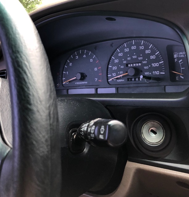

Got the newly painted pieces installed. Overall I am happy with the way they turned out. I am by no means experienced in doing this so yeah, theres some orange peel and yes, the scratches aren't buffed out completely but the pieces were heavily damaged before everything so, I think it came out nicely. Tell me what you guys think!
