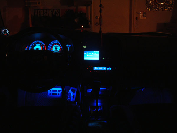

yes it's possible. ANY car could do it. it's just alot of rewiring to ONE switch. which you might need a relay. the only thing i want for my interior is a BRIGHTER dome light. is it me or my dome isn't as bright as other cars? but here's a sneak peak of my interior lights.
