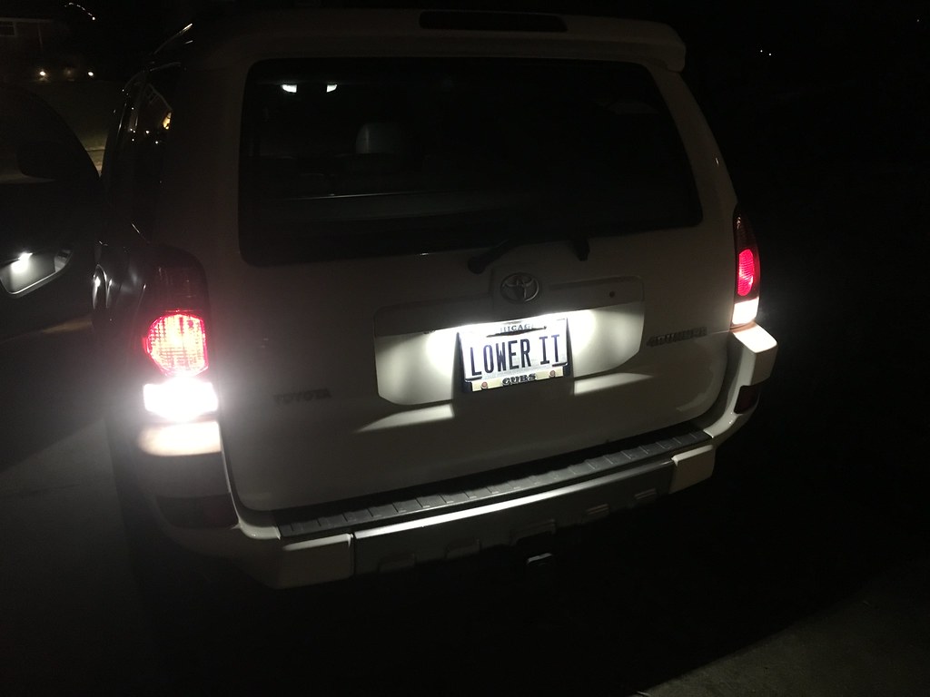

I couldn't be happier, this is natural white and the interior looks awesome! I also did license plate lights and reverse lights.

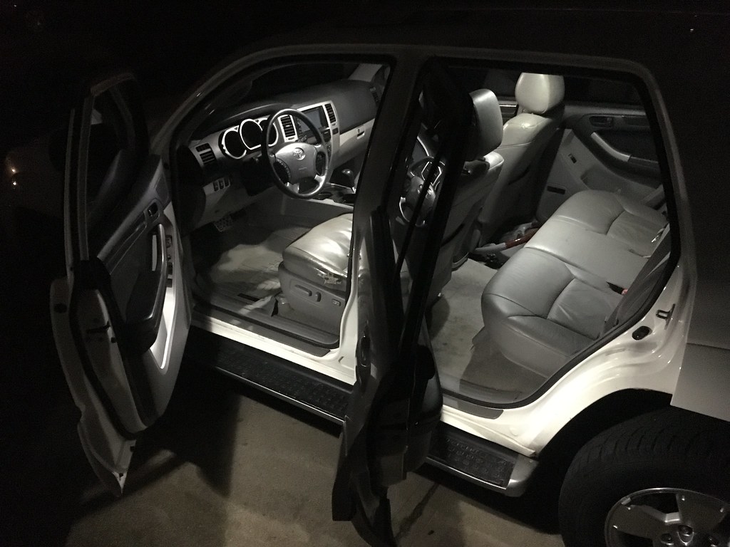

Don't forget to do the bulbs in the doors. In my opinion they made the biggest difference in terms of look when you open the door. The picture I posted is strictly the LED's in the car, no flash, and the car was parked in my dark driveway.
