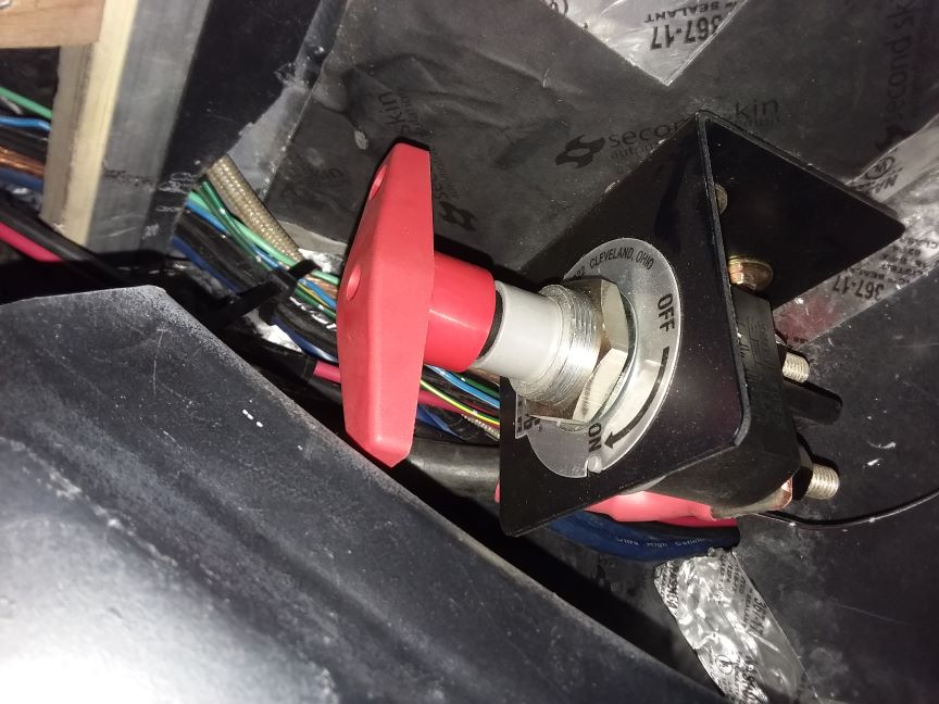

Here is my switch, 1/4 abs plastic bent 90 degrees.

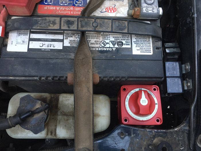

Ever-so-slight sidetrack (a forum classic) but as I'm seeing all the
different mounting spots, would the attached be considered acceptable?
It's a snug fit, so I wanted some input on it being too much in the
"blast zone" as far as collision/impact is concerned. I really want to keep
the battery-side cable as short as possible, but still maintain easy access.

[MENTION=93300]GhostRing[/MENTION] I was going to run mine there too, but it ended up being just to tight of a space with what I have. But if it works for you, go with it! I'm running 1/0 wire, it's flexible, but only so much (it's royal excelene welding/battery cable) so see how your wires will lay and mount it where ever it works best.

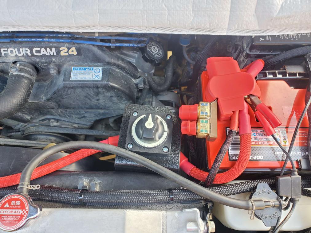

I made my own custom bus bar off the side of the battery, like this:
It runs aftermarket lights, trailer brakes/power and the winch. If the (3x paralleled) breakers fail for the winch (trip, whatever), it is easy to bypass them.
You can probably mount something right there using a stiff bus bar...
