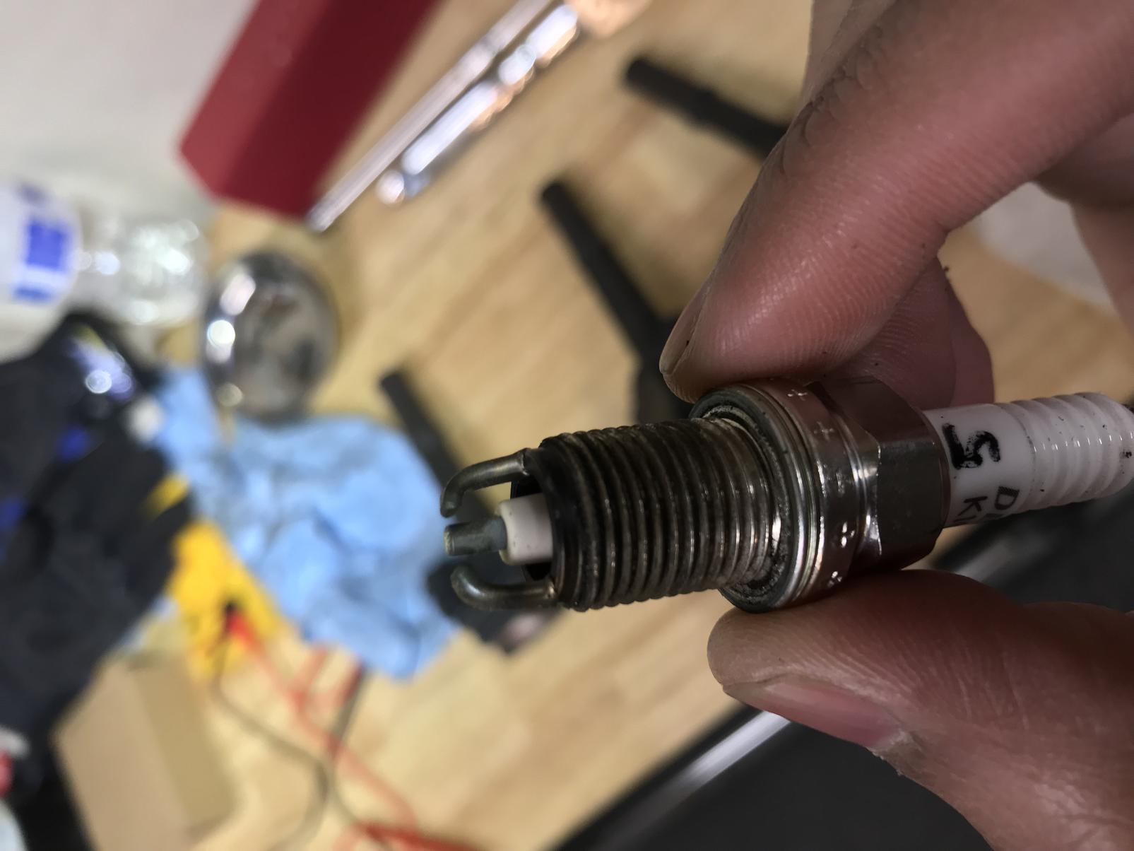

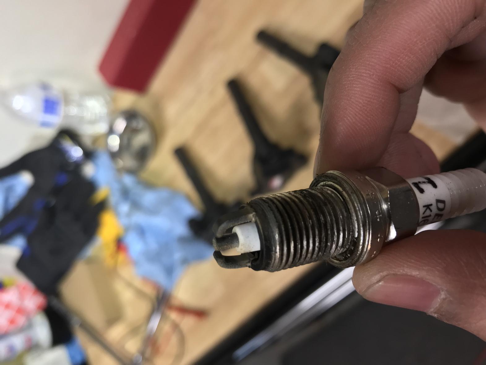

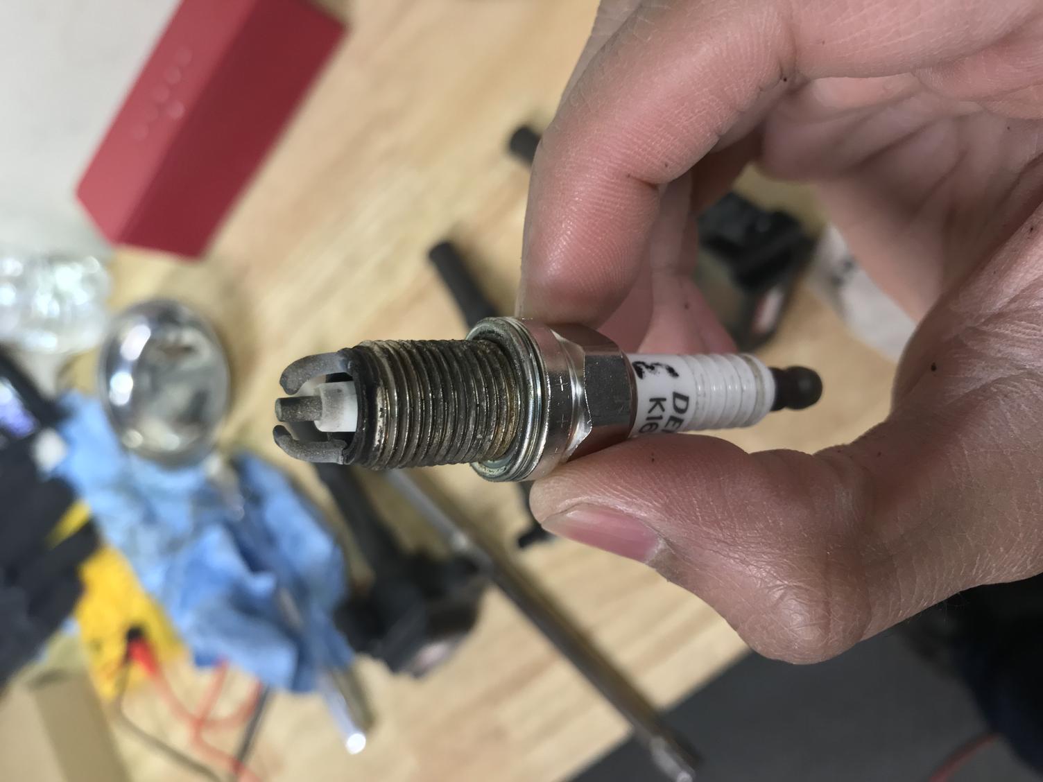

Heres plugs 1, 3, and 5. They look good to me, I didn't get a chance to check the other plugs (mainly #6), but I imagine it will look the same as plug #1.
As of now, I changed all 3 coil packs, and gave the MAF Sensor a nice cleaning, double checked my vacuum lines, and sanded down the ground next to the battery so its nice and clean (wasn't really bad before).
As of now, no misfires (look at post above), but we'll see if this holds true given that its an intermittent problem and can randomly come back.
That last photo looks like it's starting to build up soot, meaning the plug was running rich. Makes sense if the spark was not firing correctly, since it'd be flooded with fuel. None look lean (brown toasted color) which would indicate injectors not firing.
My diagnosis of what you've posted is that you had unburnt fuel in the cylinders due to bad spark. I think your idea to change the coil packs & spark plug wires will most definitely fix the issue. Good luck and I hope we don't see you post back in this thread!
