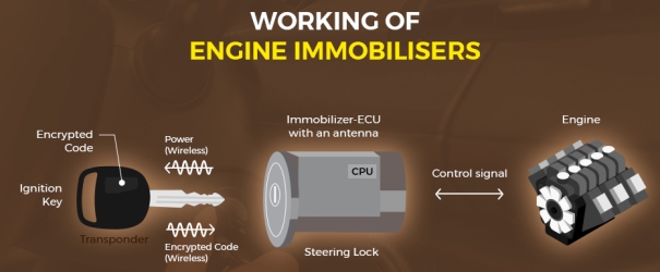

Since the red light goes out when you insert the key I would suspect the immobilizer ECU. There's supposed to be an antenna with the ECU so maybe there's something going on there. Trying another key is always a good idea. Does it behave the same way with a different key?
I think the device inside the key is like those RFIDs in expensive stuff. When you go past the devices at the door they send a signal to the RFID and that responds with an alarm. If the code isn't right it won't start, or, I guess, if the antenna or ECU can't read it, same thing; no start.
