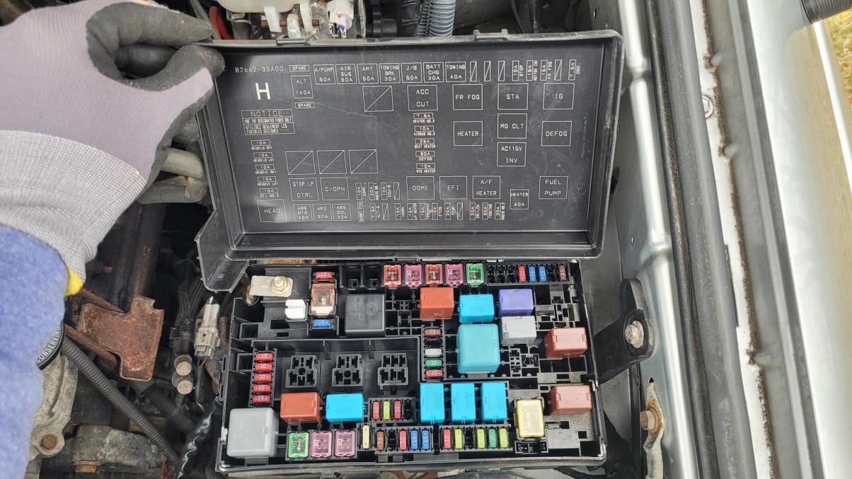

Anybody have an idea why I wouldn't have an ignition relay??
According to the diagram it should be in the upper right corner right above the Defog relay.

I just checked my '07 Limited, it has a big gray relay in that slot. Same relay as the HEAD relay if you feel like swapping yours. Unless somebody broke in and stole your IG relay, however, I'd say this isn't your problem.
