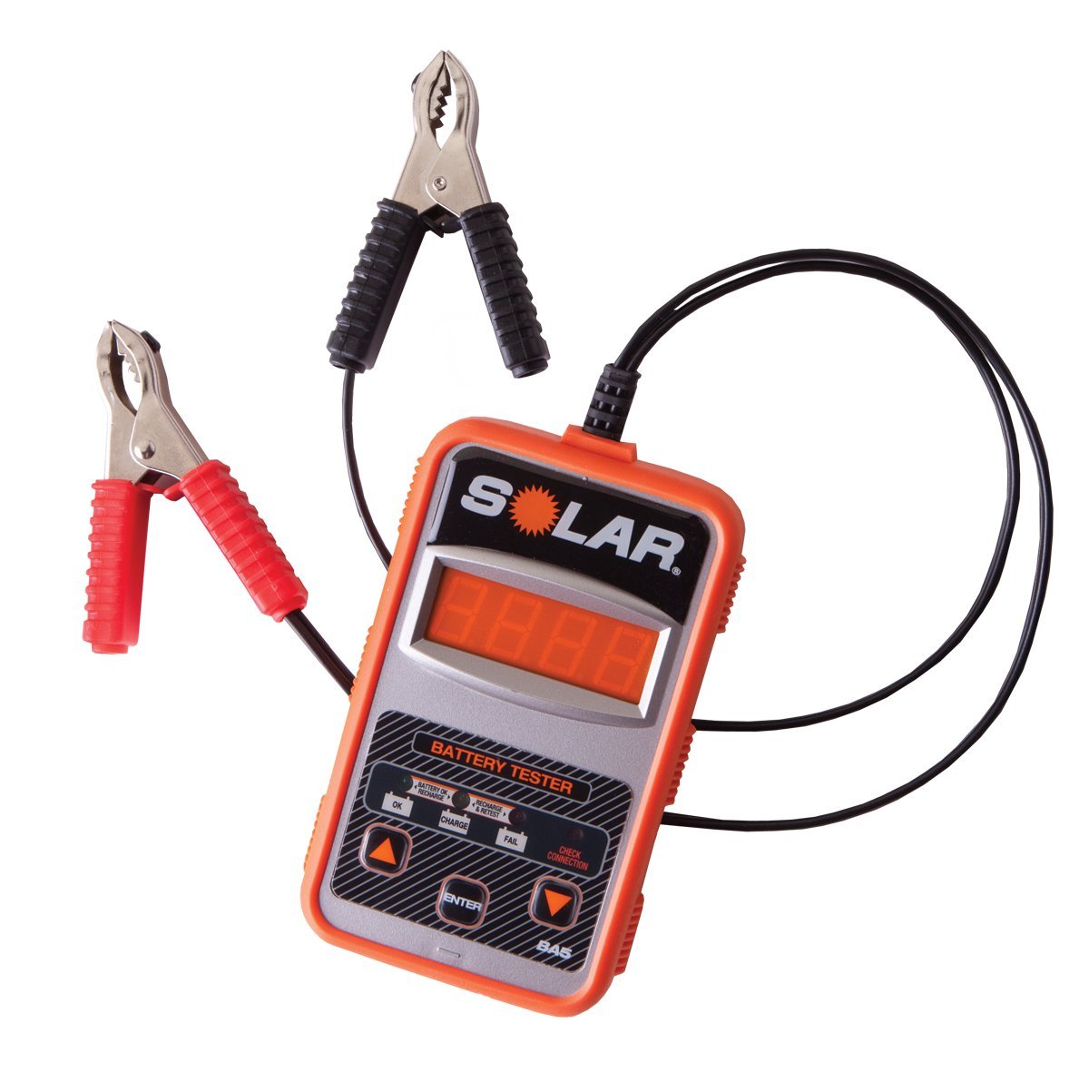

Worth every penny. I bought this to check the batteries for my bass rig.
