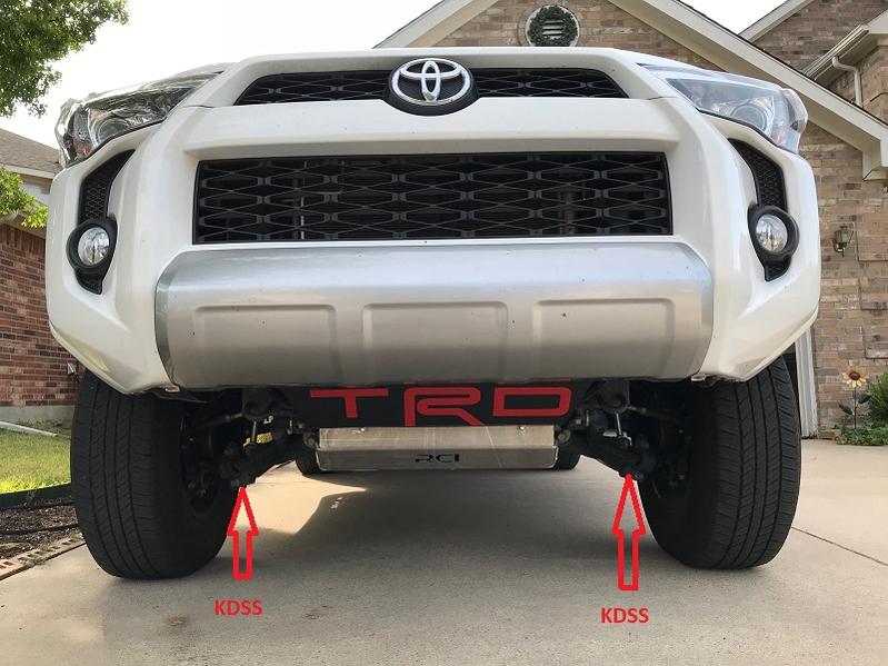

Only thing you can do is have them send you a pic of the front. Mine has an RCI skid plate rather than the factory but you should still be able to see it with a factory skid plate. Make them take a pic like this in high res so you can blow it up.
