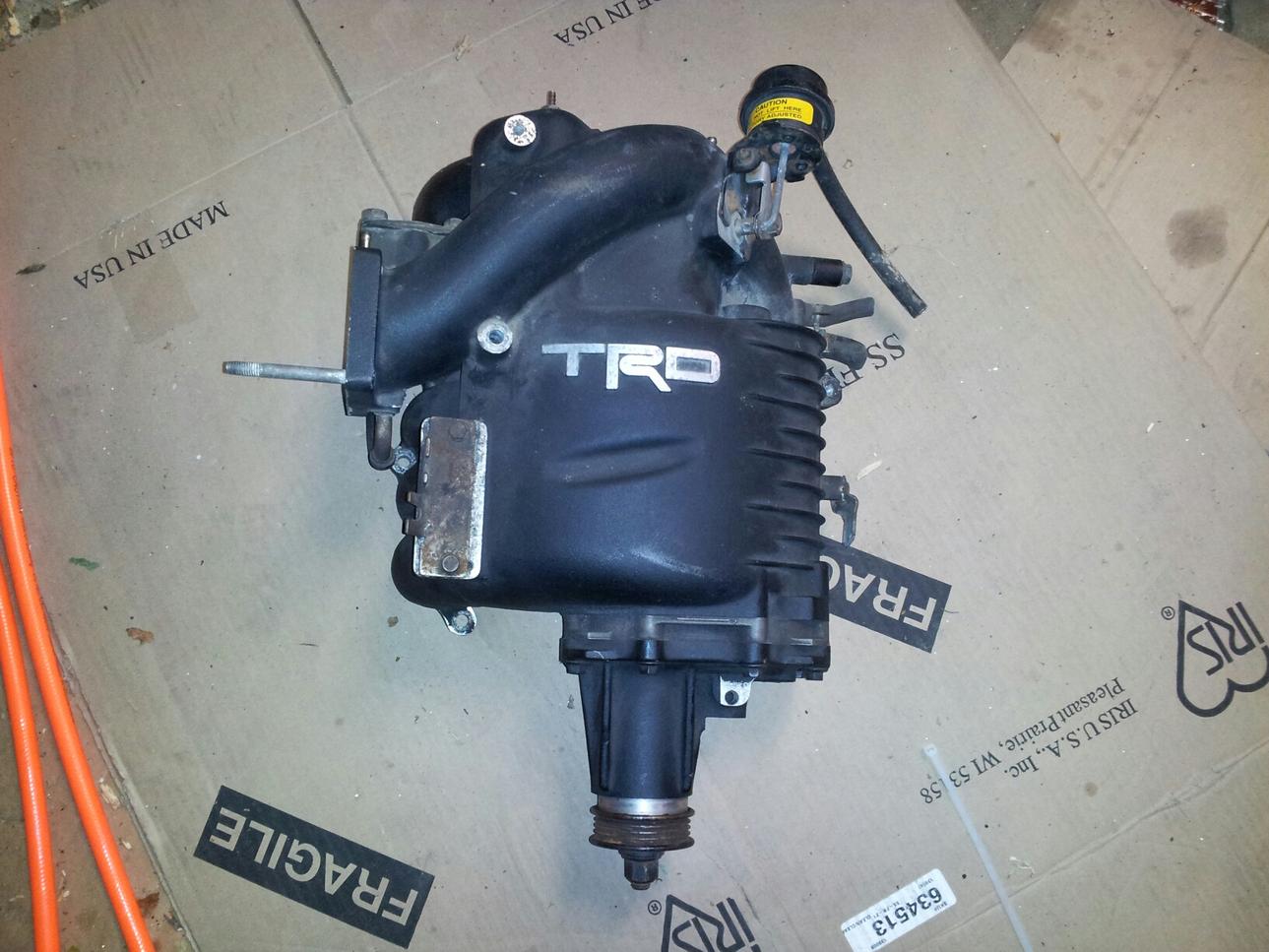

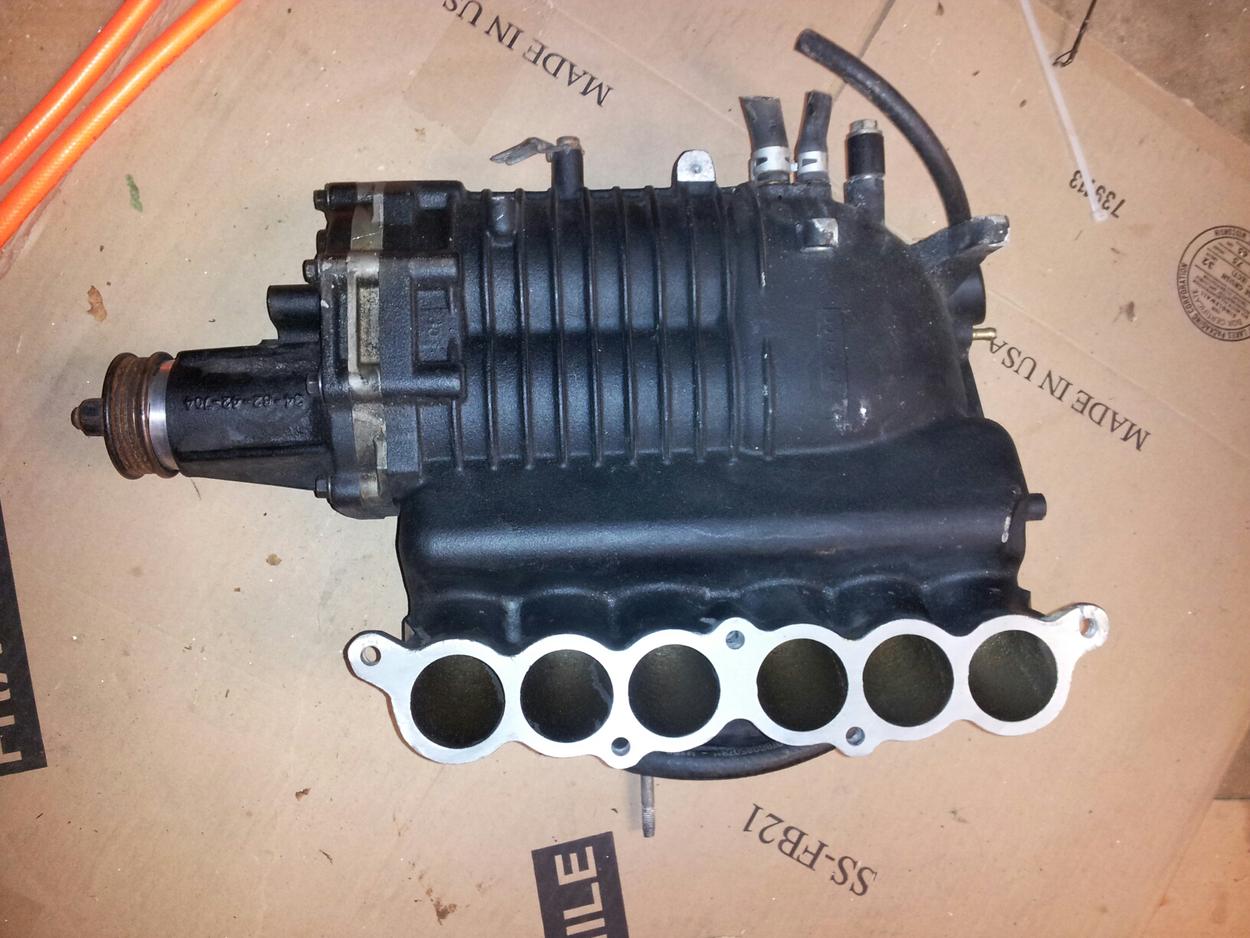

Sounds like you are on the right track! Here's a 2nd Gen Supercharger that I found on Craigslist that you may be able to do something with. http://milwaukee.craigslist.org/pts/3150122459.html $800 negotiable doesn't seem too bad, although it looks as if the nosecone may have been leaking so you may have to do a rebuild on it. $300 from Magnuson. That will definitely help you in the negotiating phase. BigFishAllDay helped me out when I was thinking about it...here's what is missing from the build if you bought that supercharger:
1. Dynamic Tensioner & Hardware (you can get this separately, online for $275-300)
2. Longer Alternator Belt, which drives the S/C (about $20 @ any Toyota Dealer)
3. 1-Way Check Valve (this is IMPORTANT to have, prob have to buy from Toyota Dealer)
4. Hardware to bolt the S/C to the intake manifold
5. TRD "O" Shaped Throttle Body Gasket (about $15 @ any Toyota Dealership
Because it is lacking parts...that will also help again in your negotiating! Best of luck with the build! Looking forward to seeing it on the road/forum. Take pics!!!
I forgot that there weren't any pics on his ad. He sent them to me and told me that the SC had around 140,000 on it but the front pulley seemed tight.
