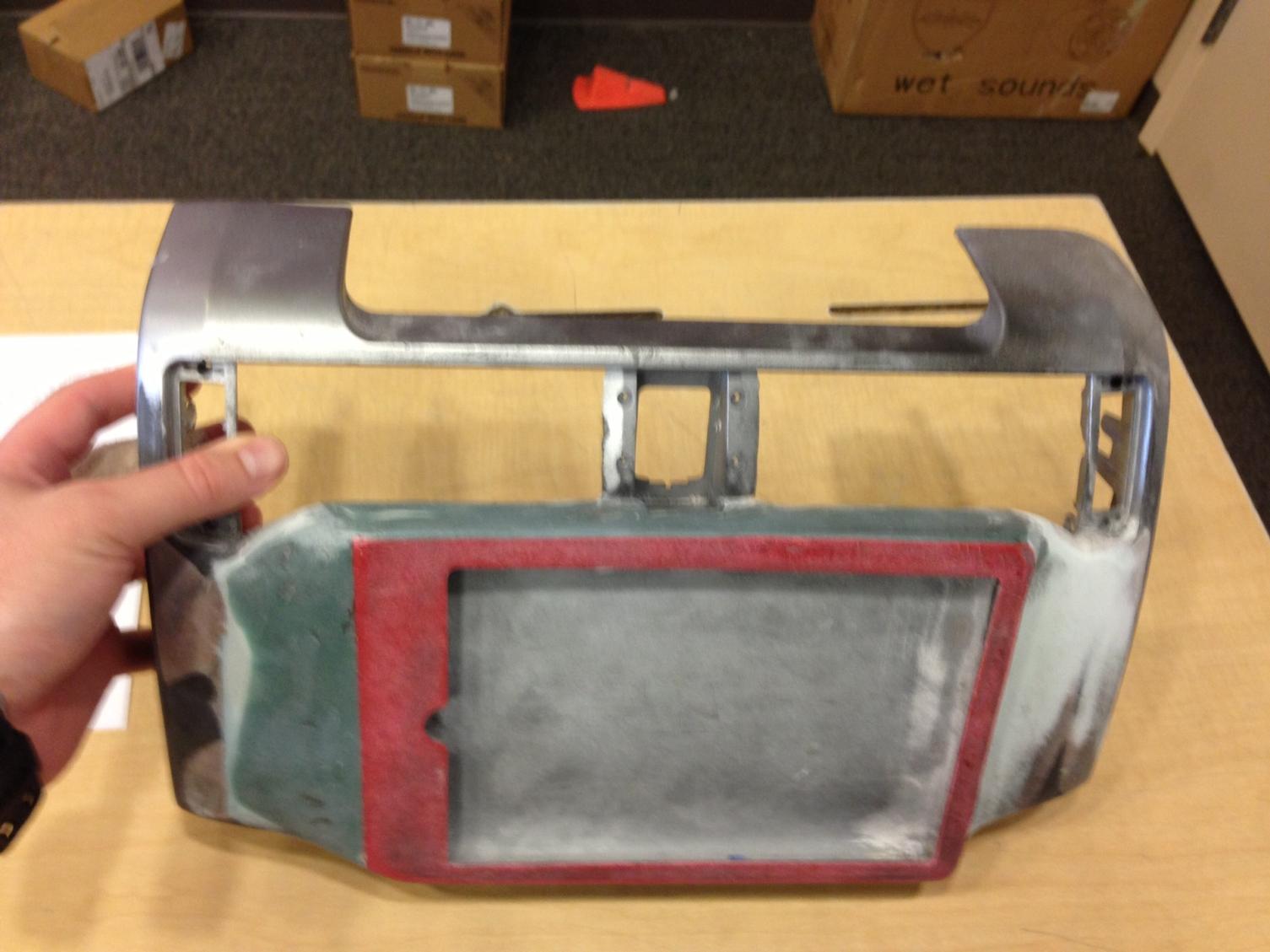

I hadn't heard anything for a week and a half about my dash mods, so I called Car Toys last Wednesday, and they said it'll be ready for me to look at on Friday. I had some vacation planned, so I made it in there yesterday morning. To say I was not pleased is an understatement...
It looks like this guy had spent maybe 40 minutes on the project, just drilling a bunch of holes in the spare dash panel I gave him (to cut weight I guess, cause they didn't serve any other purpose...), then sitting the side slider base on top of the dash and, poorly, slathering Bondo around the edges. Of course he wasn't there when I went in to look at is, so I explained my displeasure to the guy at the counter and another fabricator, told them (again), what should be happening with that kit, and ordered them to stop work immediately until I can come in and talk to the fabricator myself. From the last two weeks, I'm sure I know how that convo is going to go...:argue:

Well, the visit with the fiberglass guy went pretty well, considering the circumstances. He apologized for not getting a good enough look at the dash and how it interacts with the AC control panel/LCD panel when I first came in and his method for mounting the iPad wouldn't work (it was too low and blocked the LCD panel). So, we chatted, and he is going to move the iPad up higher and further into the dash like I had originally wanted. The negative of this is that I will lose the bottom section of my center AC vents (the bottom horizontal fin to be precise). I'll also be moving the emergency flasher button to the PARTY MODE button seeing as how that doesn't work once you go aftermarket. I'll have the wife print out a nice vinyl flasher symbol and throw it on there so it looks factory. Also, I didn't get any pictures...:happens:

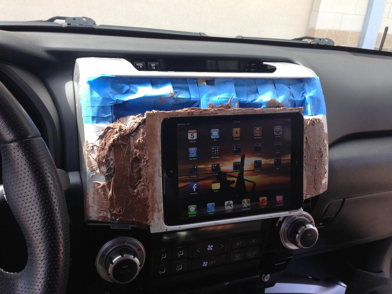

Test fit number two is complete, things are moving along nicely. He thinks he should be able to keep the flasher button where it is, but this next week will be the big test as he starts to bondo in the curves of the final product.
Right now I'm trying to decide between having someone try to match the factory paint color, doing a matte black 3m wrap, having it painted matte black, or plasti-dipping the whole thing. Any assistance there?
Pictures are attached, and you can see the vent issue that we had. Additionally, I put an anti-glare/anti-fingerprint screen from Zagg on the iPad mini and it works great in the sunlight. No issues seeing the screen at all.

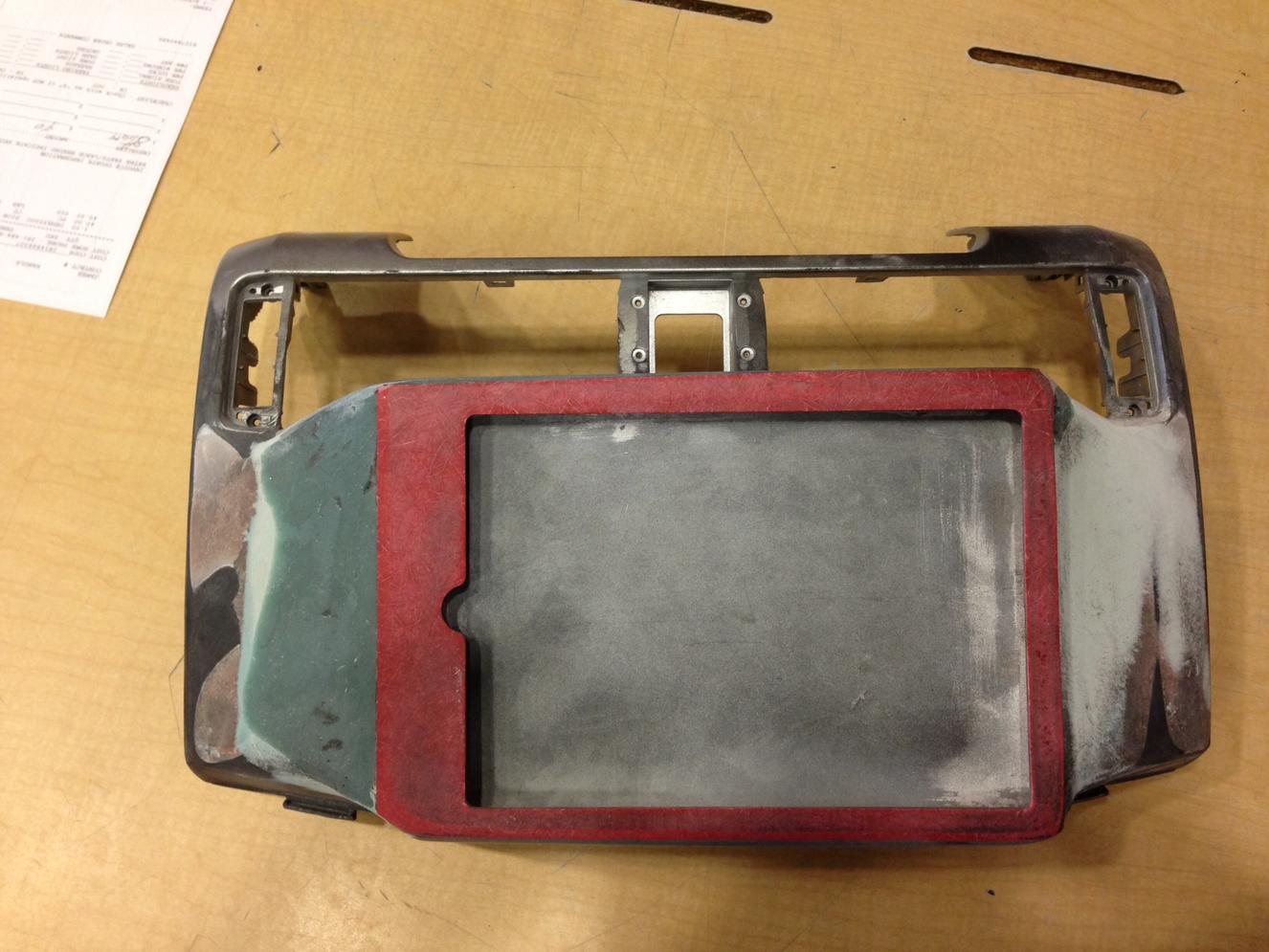

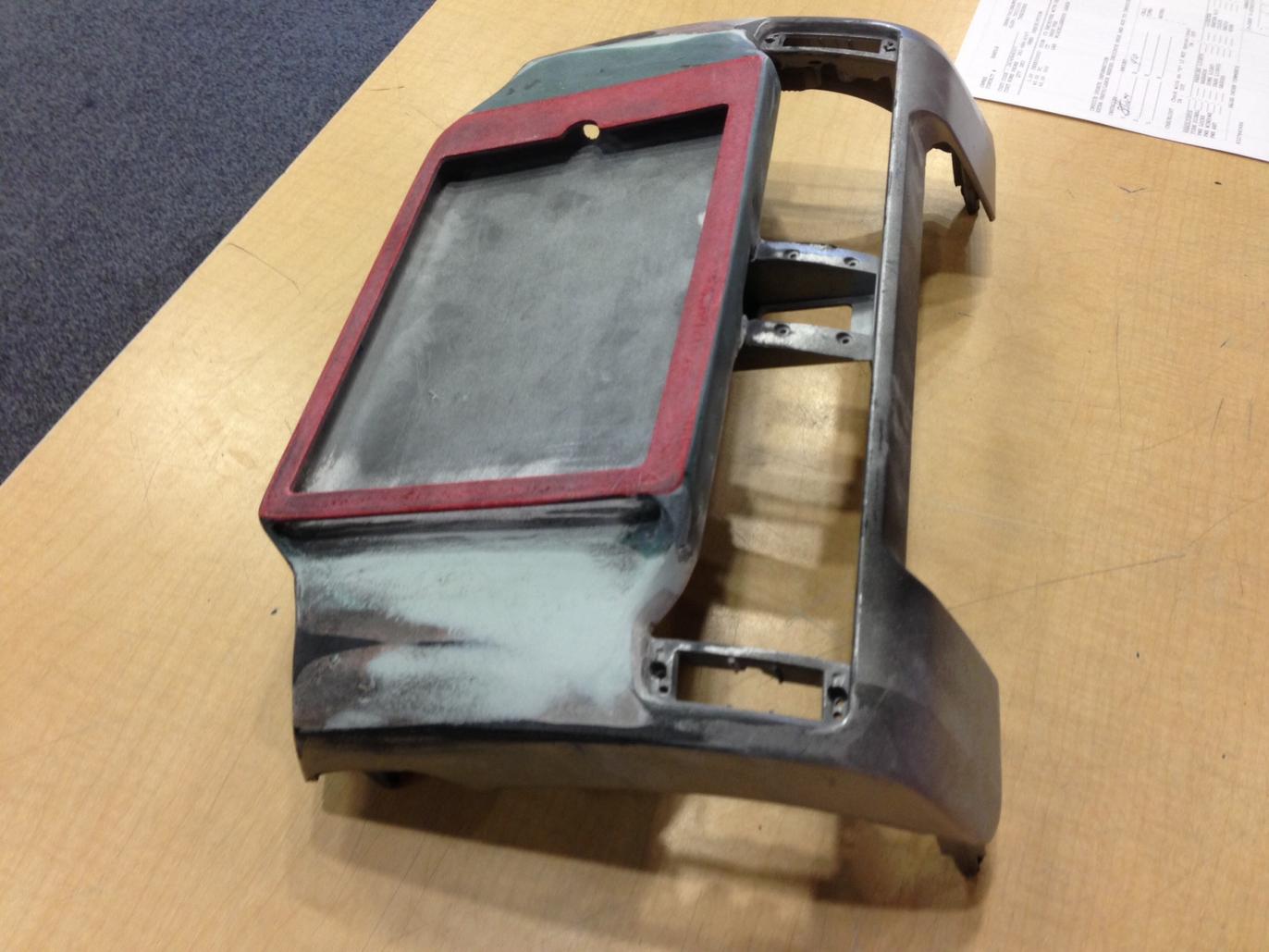

Latest update...
I stopped by again today and checked on the progress. He is about 80% done with the fiberglass, and will be starting the BONDO portion tomorrow and installing the fiberglass frame. It should be headed to paint Saturday-ish, and possibly in my car next week, but looking at my schedule I'm not optimistic.
I should have one more set of pics before it's FINISHED! Hopefully by July I'll be the proud owner of a data hog of an aftermarket stereo :llama:. More updates as they happen...

It looks like someone smeared poo on it. Seriously though, I hope it turns out well. I love the idea of an iPad in dash.

Dude.... Go find another installer. I didn't want to say anything but that is the shittest glassine something in job I have ever seen, and you are paying good money for that. It may turn out looking ok, but I used to do that for a living and I'm telling you that's trash work as a foundation. Where in tx are you, maybe I can point you towards a shop that's worth a crap.
I agree with above. I have a friend who does great work and works on and with some major industry players for a while now and this is not a great start. The work could be much cleaner and neater even at that stage. I prefer an installer who works neater from start so that they arent doing a lot of "clean up" work to hide flaws later. Good luck though, i hope it comes out up to par.

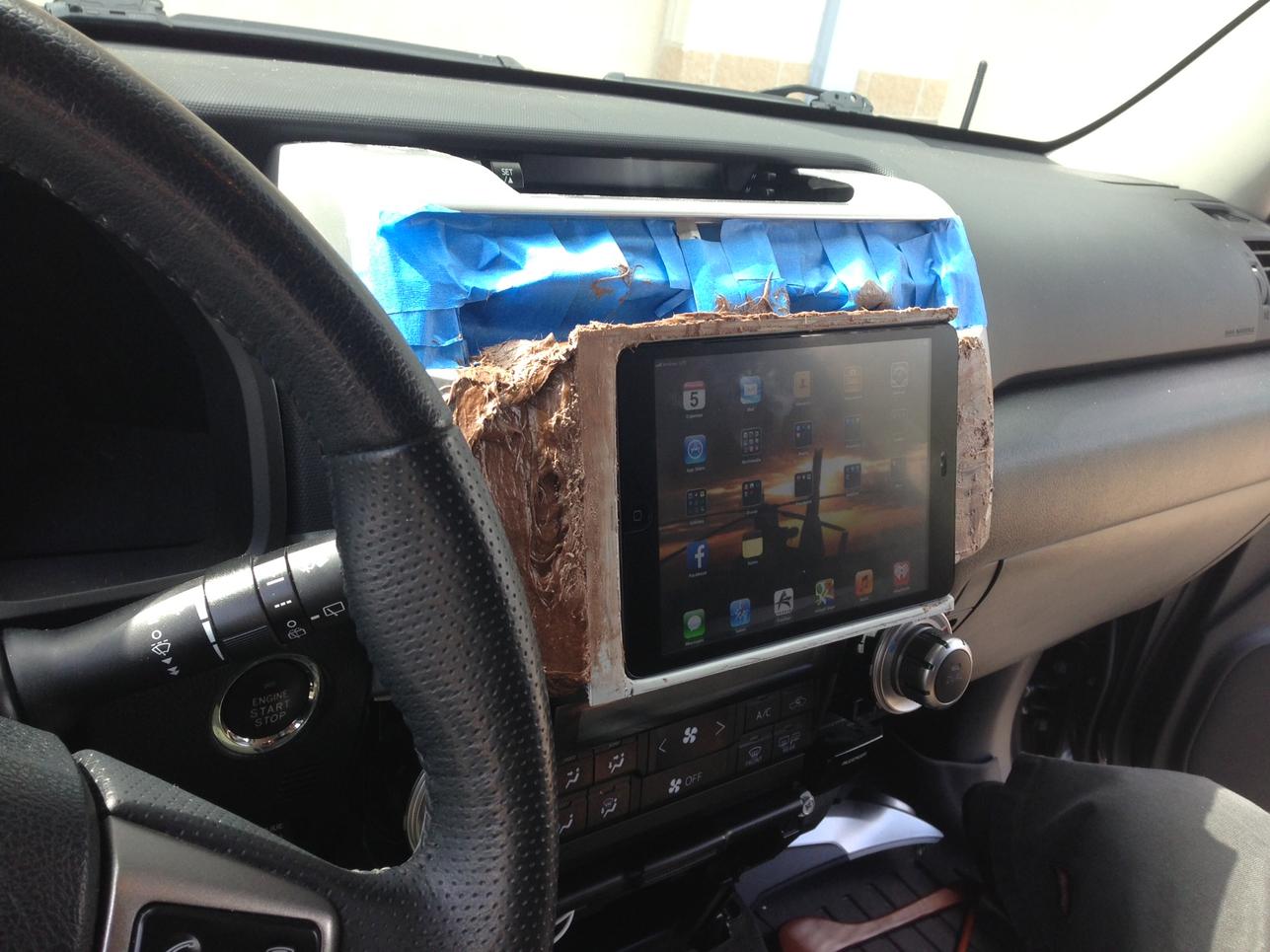

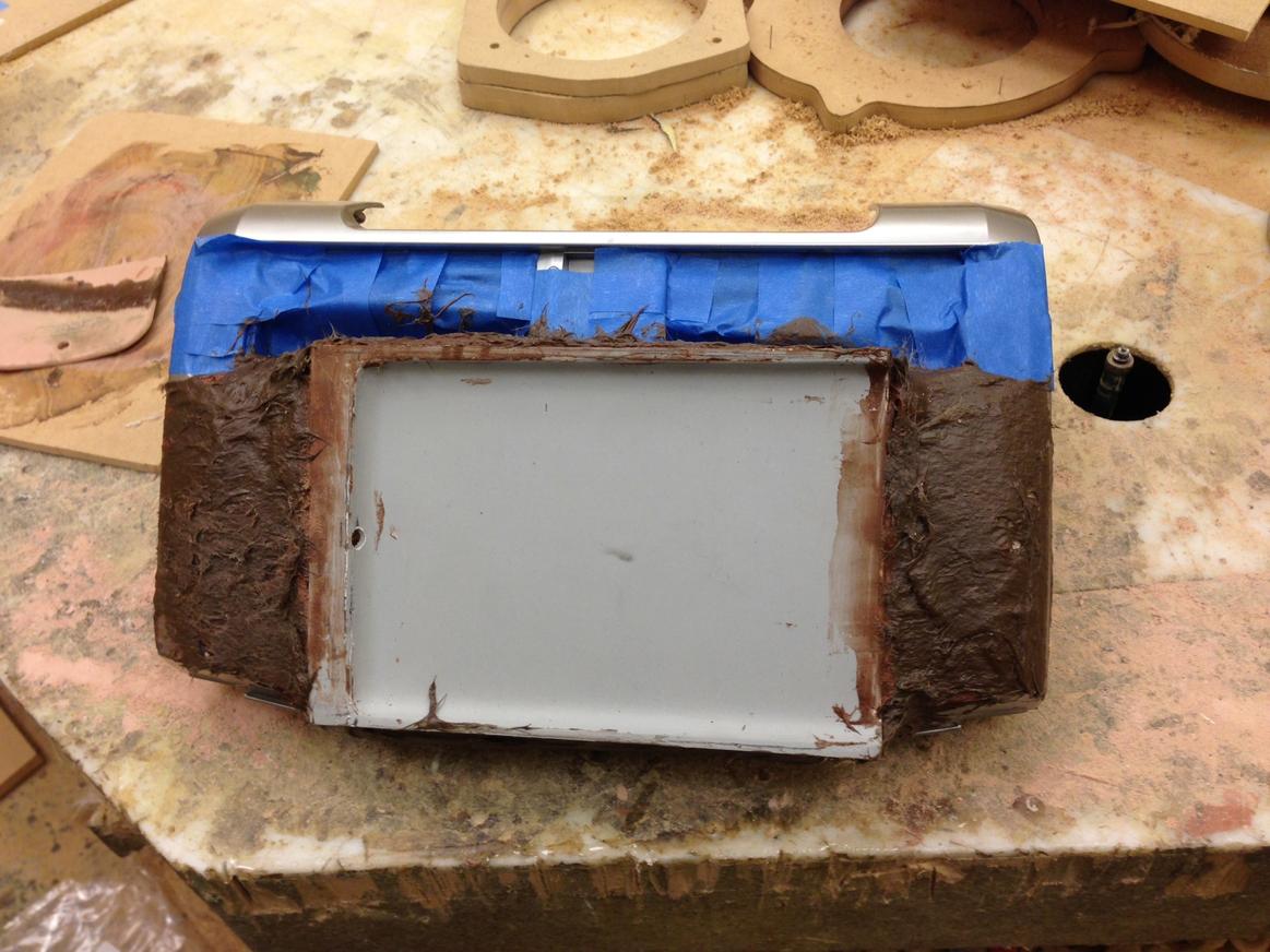

he made quite a bit of progress over the last week, and the mount will be headed to paint next monday or tuesday. As you can see, in order to ensure you can still see the a/c controls, we had to raise the ipad up on the dash, which requires a small modification to the vents. I'll be losing the bottom fin of the vents, and the hazards button will move down to the party mode button. my wife will cut out some vinyl to make a hazard symbol and cover the party mode wording. all in all I'm pretty happy with it, I knew it wasn't going to be perfect due to the size issue, but when you see it in person it looks pretty good. the next set of pics should be after paint and ready to mount...

Hey there, sorry I never got back. Looks like he slapped the bondo on and went to town! If you end up not being happy try rocky at rockstar designs. I am curious to see how this ends up, I have had a few thoughts about the iPad thing myself... You can get toslink out to a processor and use apple lossless for a full digital signal, which appeals to me.
