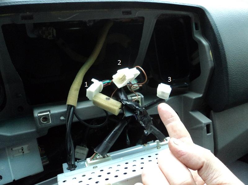

At the HU, #3 is the original plug, #1/#2 go to the interface unit. #3 plugs into #2 and #1 plug into the HU

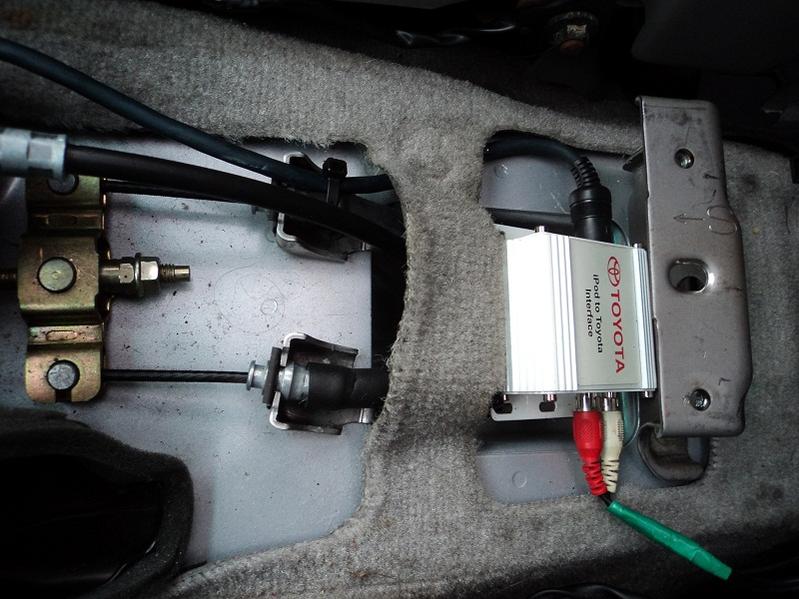

Its got two sided tape on the bottom and I zip tied in down, it's pretty solid there.

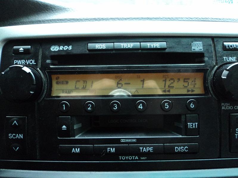

It comes up as CD1 and it always says disc 6 track 1 and the time just counts up lol.

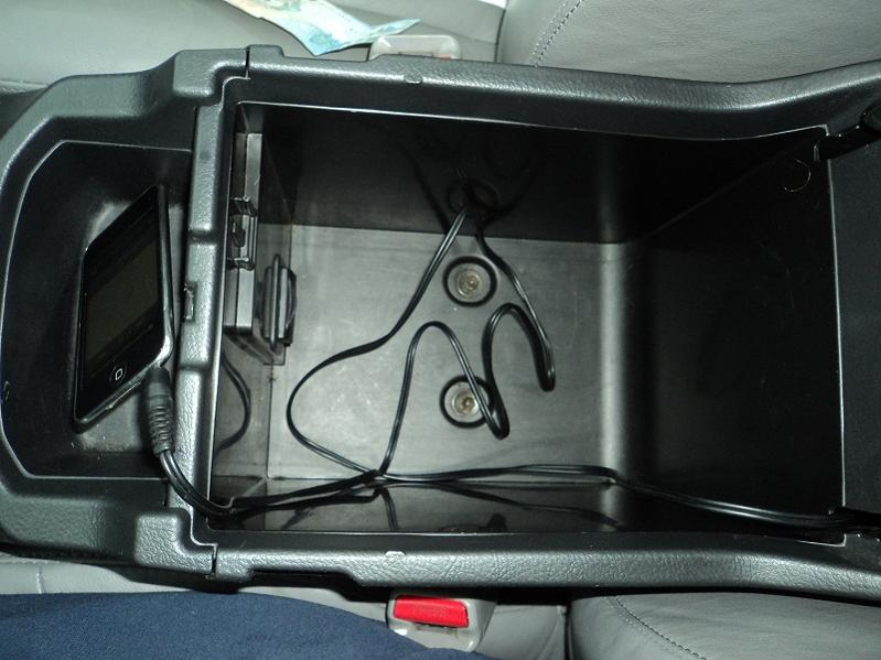

I didn't want to drill holes because i'm not gonna kept this setup forever.
