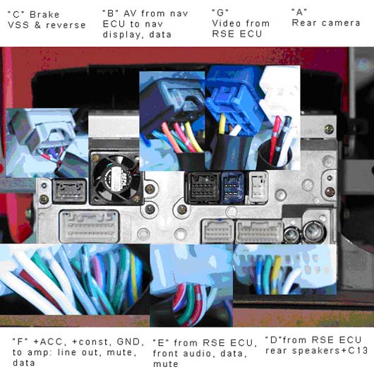

I am trying to figure out what I want to do for bluetooth in my 4runner. You can't use any of the adapters for the amplified system. Someone in Duc Hunter's thread said they had gotten there kit to mute the radio when it rings by tapping into the harness. I don't have any diagrams so I don't know how successful I would be doing that. I just upgraded my cingular account to the treo 650, and would like to get the bluetooth working so I could use the speakers and no external speaker.
If anyone could provide more detailed info as to how this could work, then please post...

B10-TX-
C: Misc.
C1-Parking Break
C3-SPD
C5-REV
D: Combination Switch + RSE ECU
Combination Switch:
D6-GND
D7-AU1
D8-AU2
RSE ECU:
D14-SLD1 (Shield main)
D15-RSR+ (SH)
D16-RSR- (SH)
D17-RSL+ (SH)
D18-RSL- (SH)
D19-RMU
E: RSE ECU
E1-SLD (Sheild main)
E2-R+ (SH)
E3-R- (SH)
E4-L+ (SH)
E5-L- (SH)
E6-MUTE
E9-TX+
E10-TX-
F: Misc + AMP
F1-B+
F5-TX+
F7-MUTE
F8-R+(SH)
F9-L+ (SH)
F10-SLD2 (Shield Main)
F11-ACC
F13-ANT
F15-TX-
F18-R- (SH)
F19-L- (SH)
F20-GND
G: RSE ECU
G3-NTS1 (SH)
G5-SGN1 (Shield main)
G6-SG3 (SH)
Tap into F7 off the harness with the mute wire (yellow on mine) from the bluetooth kit. As far as using the stereo speakers that would be a little more difficult with the JBL 10 without some kind of interface cable or someone that knows more than me. I put my external speaker up in the dash right below the instument panel. With the mute function the sound plenty loud.
