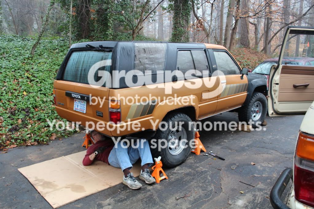

So first impression of the kit was that it was well put together and included everything for the driveway mechanic to install it. So here's a little before shot next to my 4runner(3" TG lift with 35's) his has 32" all-terrains.
IMG_0112.jpg~original

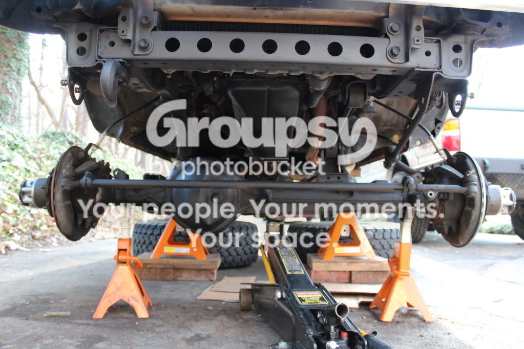

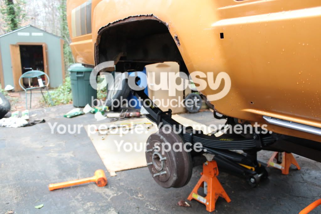

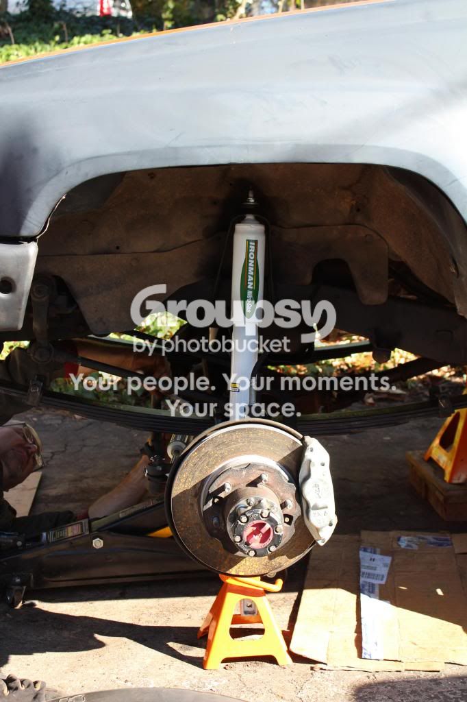

So i'll let the rest of the pictures do the talking.

So after everything was done I am very pleased with how it came out. It rides great, able to retain stock steering, was very easy to install. It was all done with hand tools and a harbor freight electric impact gun. Probably took a day total taking our time, because my dad wanted to learn about everything as we went along so I helped explain what everything was. So I hope this helps anyone out if they are debating what lift to go with.
