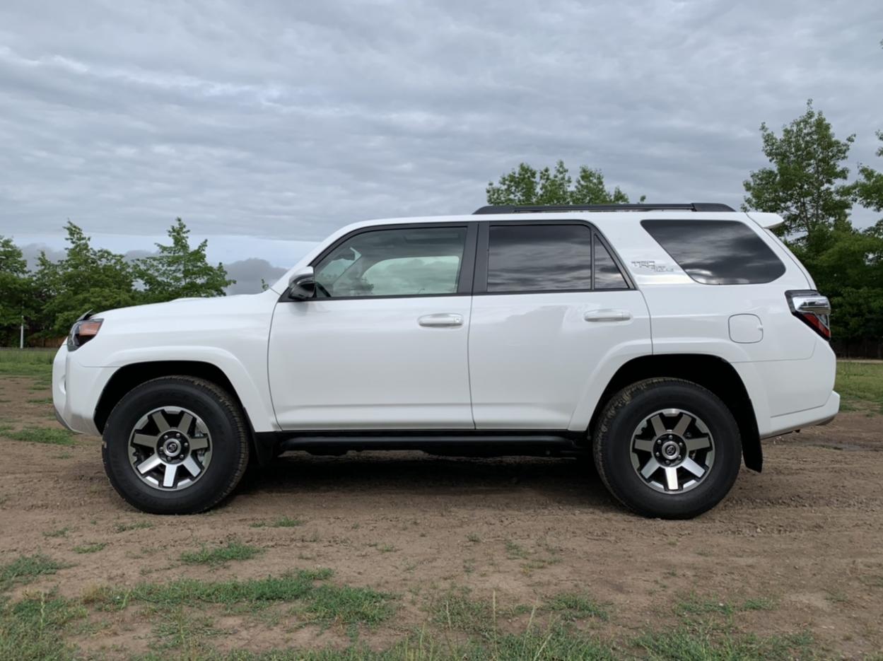

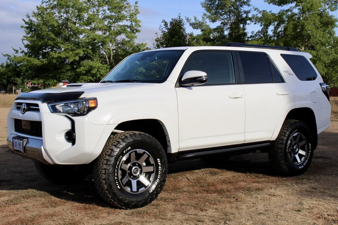

Posting an update to this thread- below is a link to my Ironman Nitro Stage 2 kit. Very happy with the result. With 5mm spacer on Drivers Front, lean is now gone.
Before measurements:
DF 19.5”
PF 19.875”
DR 21.5”
PR 21.75”
After measurements:
DF 22.5” +3”
PF 22.75” +2.875”
DR 24” +2.5”
PR 24” +2.25”
Ironman 4x4 Nitro Stage 2 Lift
Before (265’s) and after (285’s) shots:
