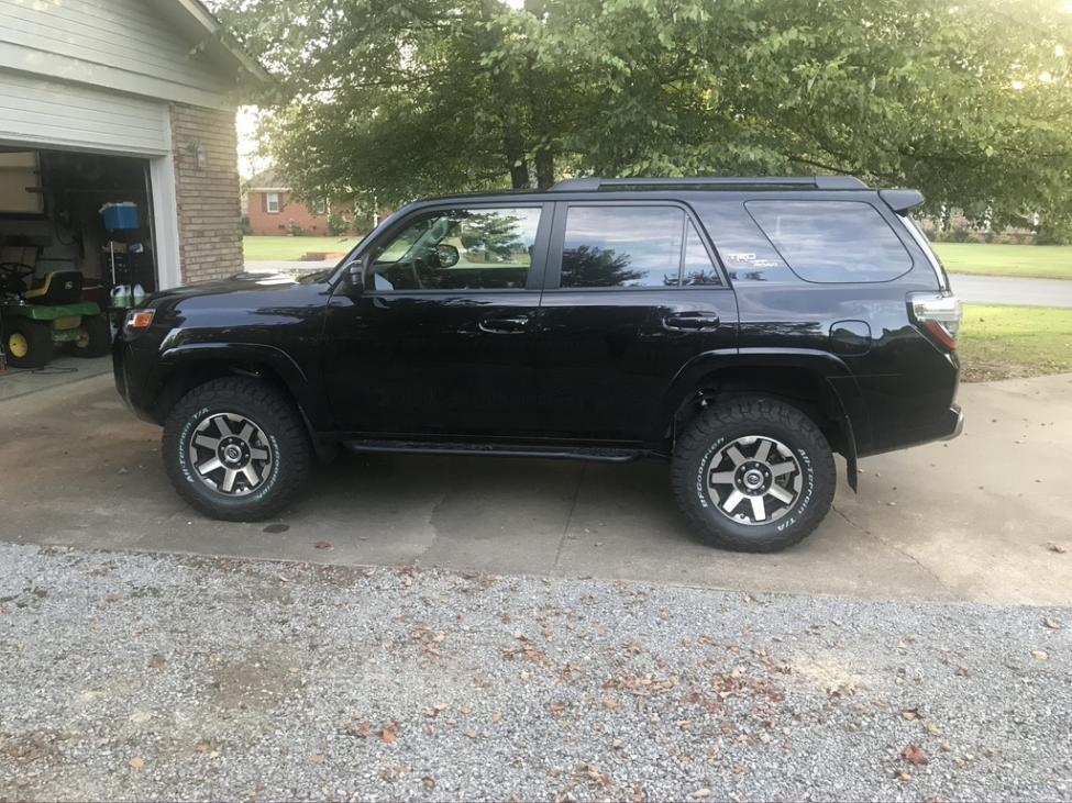

I went with Nitro shocks and have no regrets. Talked to Chris Wagner @ Ironman and after we talked he actually suggested Nitros for my use. I went with Medium springs front and rear as we will be adding a bumper and winch on the front and we tow a Smittybilt Scout trailer with it also. I didn't use spacers nor did I get before and after measurements wish I had now.

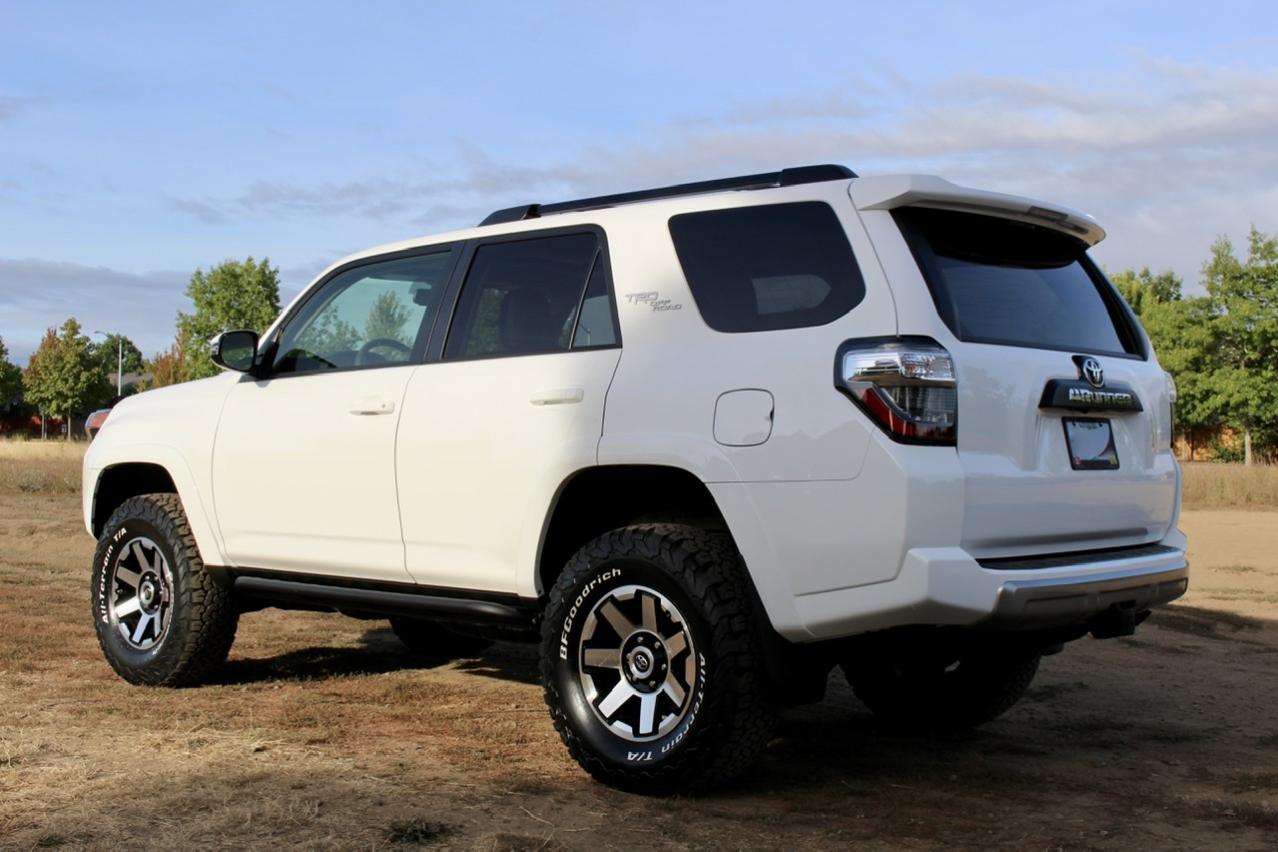

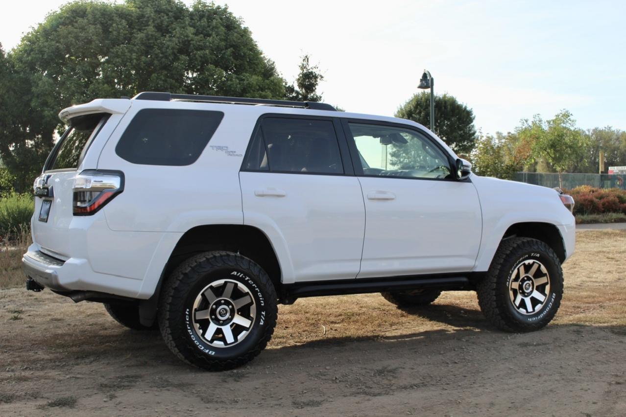

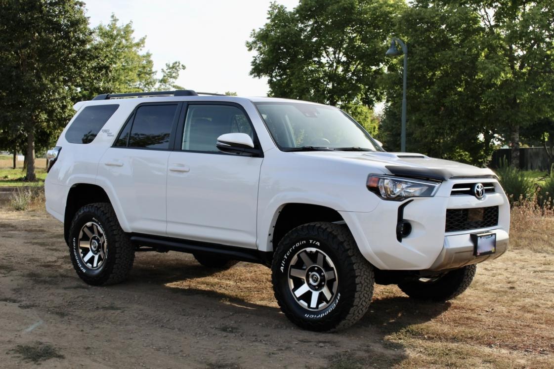

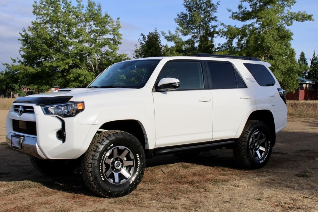

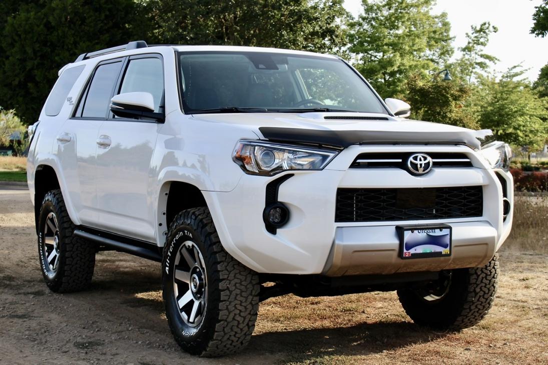

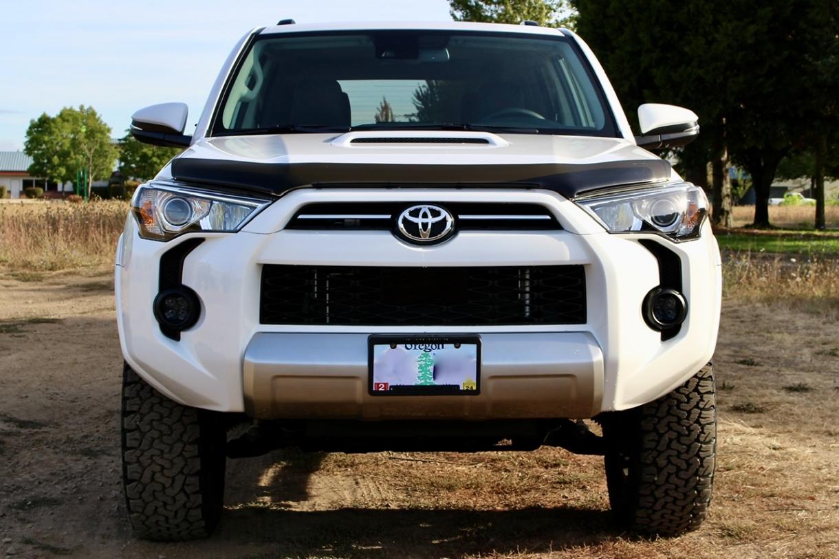

September update: 2.5 months in & ride continues to feel planted, stable and sporty.
Took measurements and confirmed no additional settling.
Washed her up and took a few pics from different angles. Perhaps will help someone down the road know what to expect with this lift.

Did you have any errors after doing the install? I just did the same install and am getting the VSC error. Did you have any similar issues?
@Run_Forrest_Run - Great looking setup. I'm interested in the Ironman Nitro setup as well but was a little worried about the stiff spring rates at 669lbs/in and 280lbs/in. Can you say how much firmer than stock they feel to you? Are you carrying anything in the rear?
I carry @100 lbs of tools and towing equipment.
The ride is a world of difference. It went from driving like a station wagon to driving like a proper 4x4. It’s not too stiff in my opinion, just very stable. Not harsh, but firm. If I did it again, I might go with the A springs for rear. I like the rake, but would be perfect if it was 1/2” lower in back. That said, I’m very happy with the result. I would not spend any more to replace rear springs. Hope this helps- Good luck!
Your thread has been super helpful and I've just bought a nitro kit for my 07. I got the 1.5" A rated rear coils since I don't have any bumpers, RTT, etc. I was also worried about the 8xx lb front performance spring but found the FJ coils have much lower spring rates. You have the B FJ coil at 660 lb so how do you like that up front? When you hit speed bumps or pot holes how would you describe the car reacts to it? I'm debating the A or B FJ coil up front and since the 4th gens are a little lighter than the 5th I'm leaning towards the A. Thanks for all your pics and write ups!
Congrats! I like my ride, can’t imagine 8xx lb coils... When I hit bumps, it’s firm vs getting soaked up. I’m sure the shock plays a part. The rear feels firmer than the front over speed bumps. Sounds like you will be happy with A’s in the rear. For your front coils, I suggest you choose A for comfort, B for little higher lift if you’re good with firmer feel. Hope this helps.
