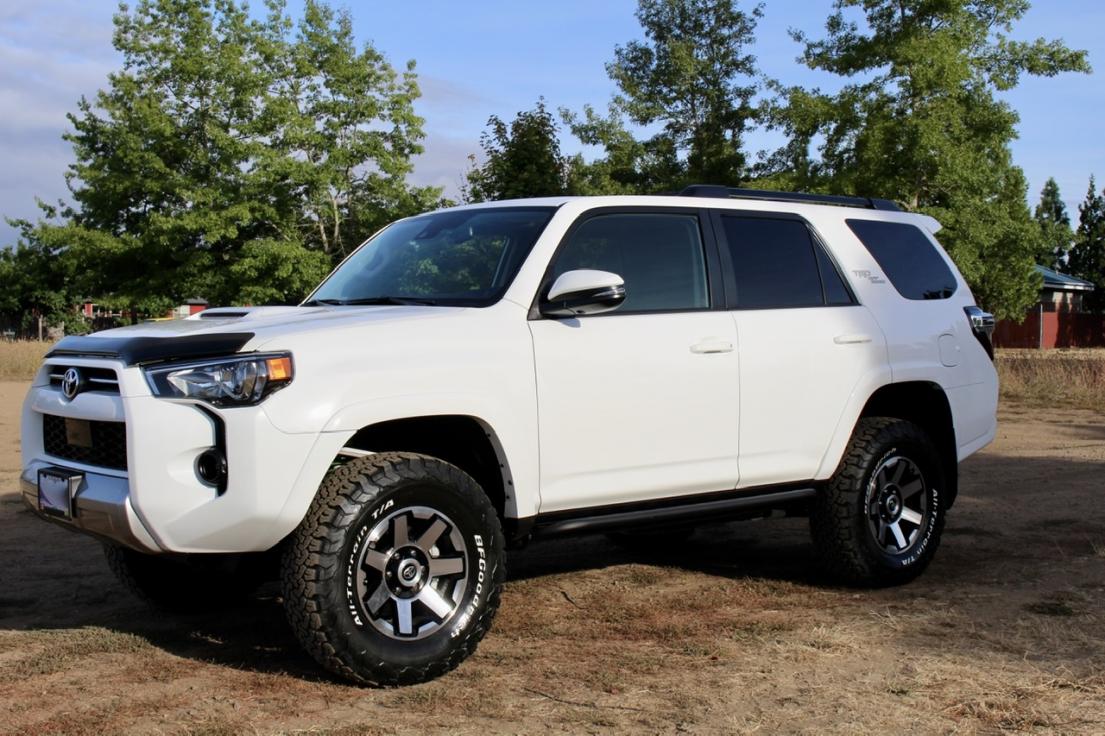

Kit came today and it took me 6 hours for a solo install. Ironman GX460 Facebook video was a great help. Everything went smooth and I’m extremely satisfied with the result. Here are my new measurements after a test drive and @ .5” settling up front:
DF 22.5” +3”
PF 22.75” +2.875”
DR 24” +2.5”
PR 24” +2.25”
Will be letting it settle, then plan on an alignment and some new shoes. At the moment Im very happy with the results & recommend it highly.

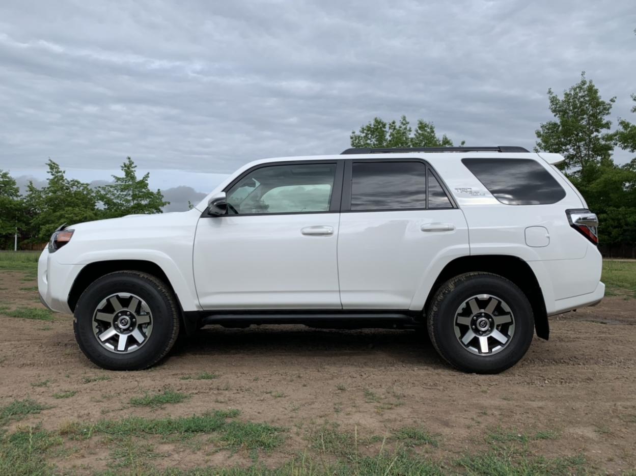

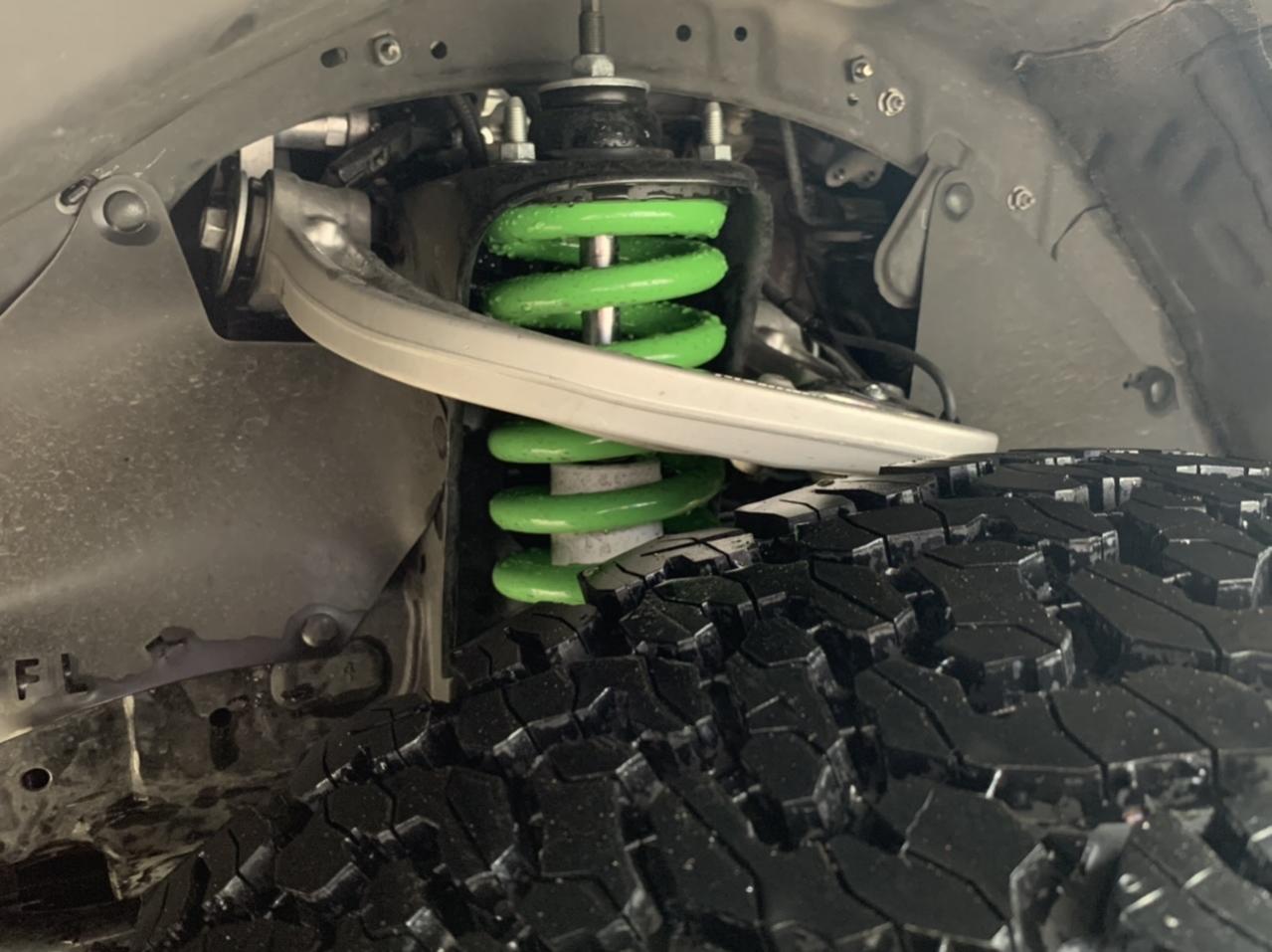

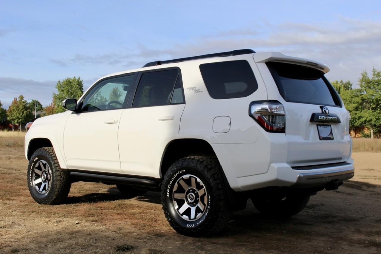

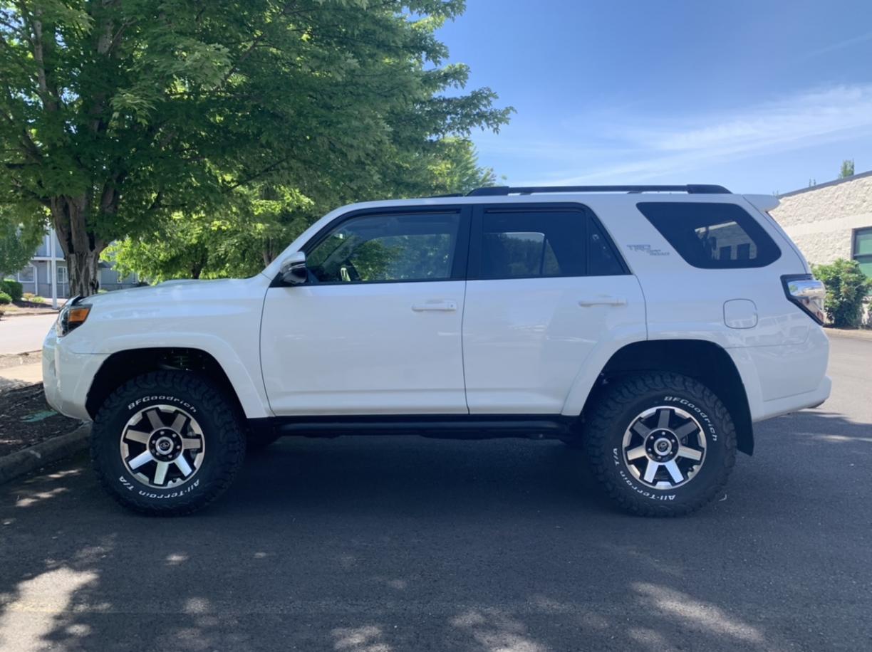

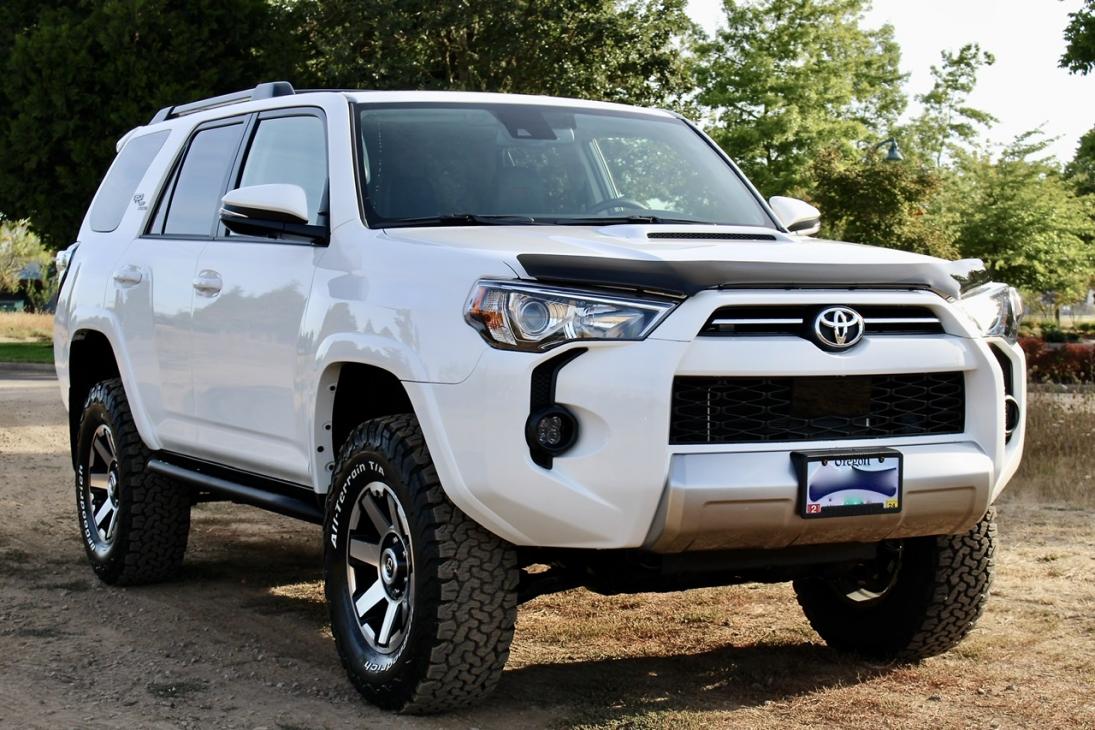

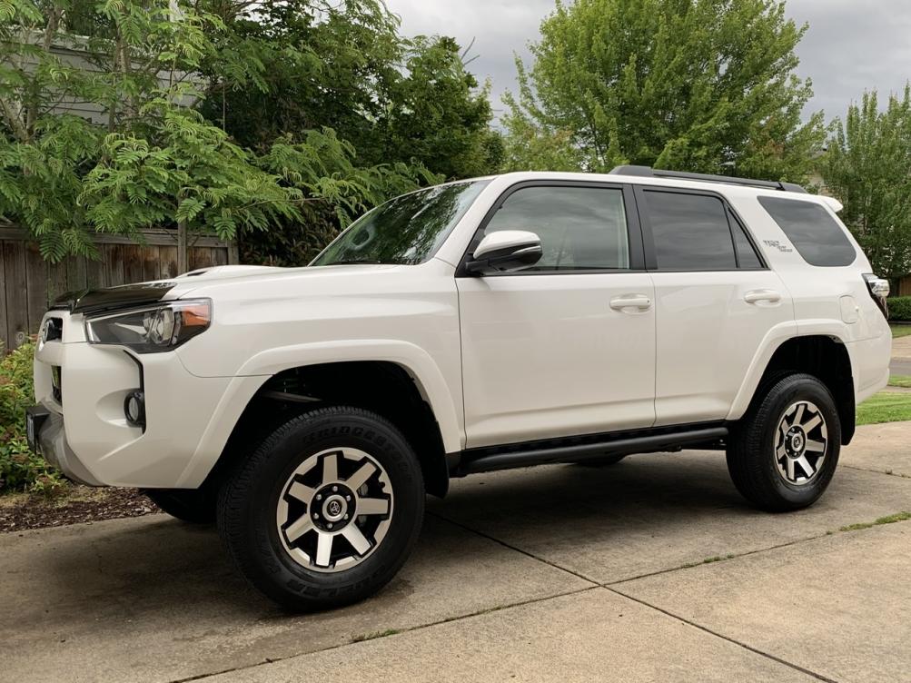

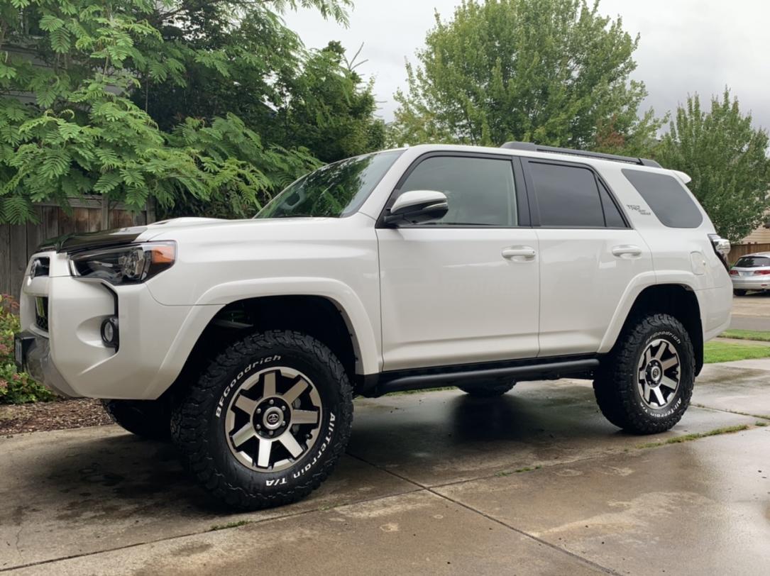

Update: Added images of before lift with Bridgestone 265’s and after with BFG KO2 285’s

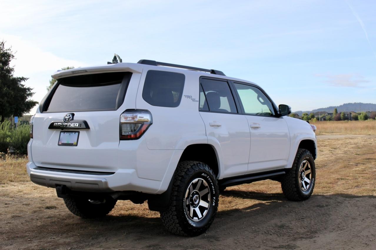

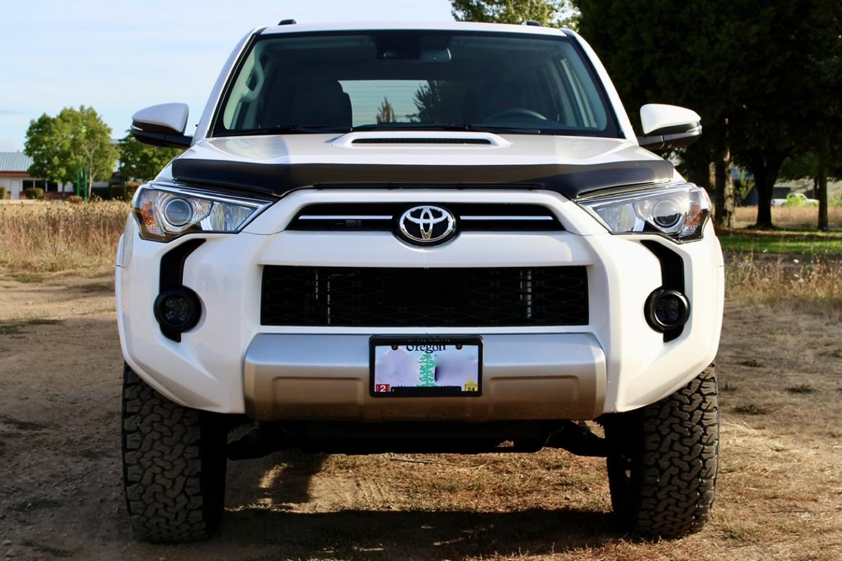

Installed BFG KO2 285/70R17 in load range C. Had some rubbing at full lock on incline, so removed front mud flap, pushed front fender liner forward and trimmed the bumper. Was a little nervous to do this...after some reading, was a simple job. Well worth the work to fit these tires. Clearance looks good now and the stance is exactly what I was wanting. Will report back after some more miles.

So you still had back rubbing with a 4* Caster on 285s? I have Falken AT3W on 285s E with OEM UCAs and it makes me thinking if indeed the Ironman UCAs will perform... hmmm
There does seem to be different experiences about which tires require trimming, etc. I don’t know the UCA plays much of a role there though. I could have had caster increased beyond 4*, but wanted to stay closer to Toyota spec. Mud flaps were removed before installing tires because I have sliders with top plate to protect the body sides...and like the look without them.
Note that rubbing was on the drivers side front inside fender liner, not passenger. It did appear that my passenger fender liner was pushed back further from the factory. Perhaps there is an OEM range they come with?
I pushed back the drivers side about 1.25” and passenger about 1” to be safe. While the tires were off I went ahead and used the Dremel to take 3/4” off the lower bumper....to be safe and to avoid rubbing when off road and tire pushed up further into the wheel well.
Perhaps my fix was over the top, but I would rather fix it for good once than run the risk of destroying fender or bumper while off road when the wheel is stuffed up in the well.
