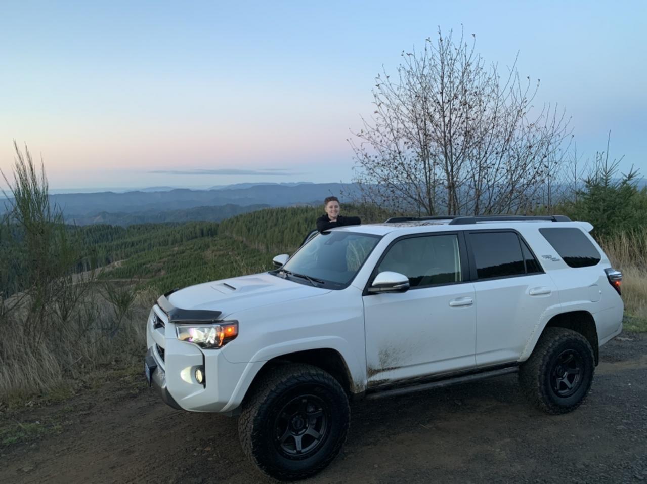

November, 5 month update:
Checked measurements last week with Ironman performance B springs and found the front settled (-.25”) to 2.75”. Rear was still holding at 2.5”. The large OEM rake was just not quite right to my eye..... So... Black Friday deals brought me a set of RRW RR2-V wheels and OME 2895E rear spring replacements. OME’s dropped rear down to a 2” lift.
Now sitting at 2.75” in the front with IM & 2” in the rear with OME. Visually still have a slight rake & much better balance to my eye.
Got out on some BLM roads on a day hike and very happy with the result.

Installed BFG KO2 285/70R17 in load range C. Had some rubbing at full lock on incline, so removed front mud flap, pushed front fender liner forward and trimmed the bumper. Was a little nervous to do this...after some reading, was a simple job. Well worth the work to fit these tires. Clearance looks good now and the stance is exactly what I was wanting. Will report back after some more miles.
Looks Really NICE! Any concerns with the KDSS on the install of this?
