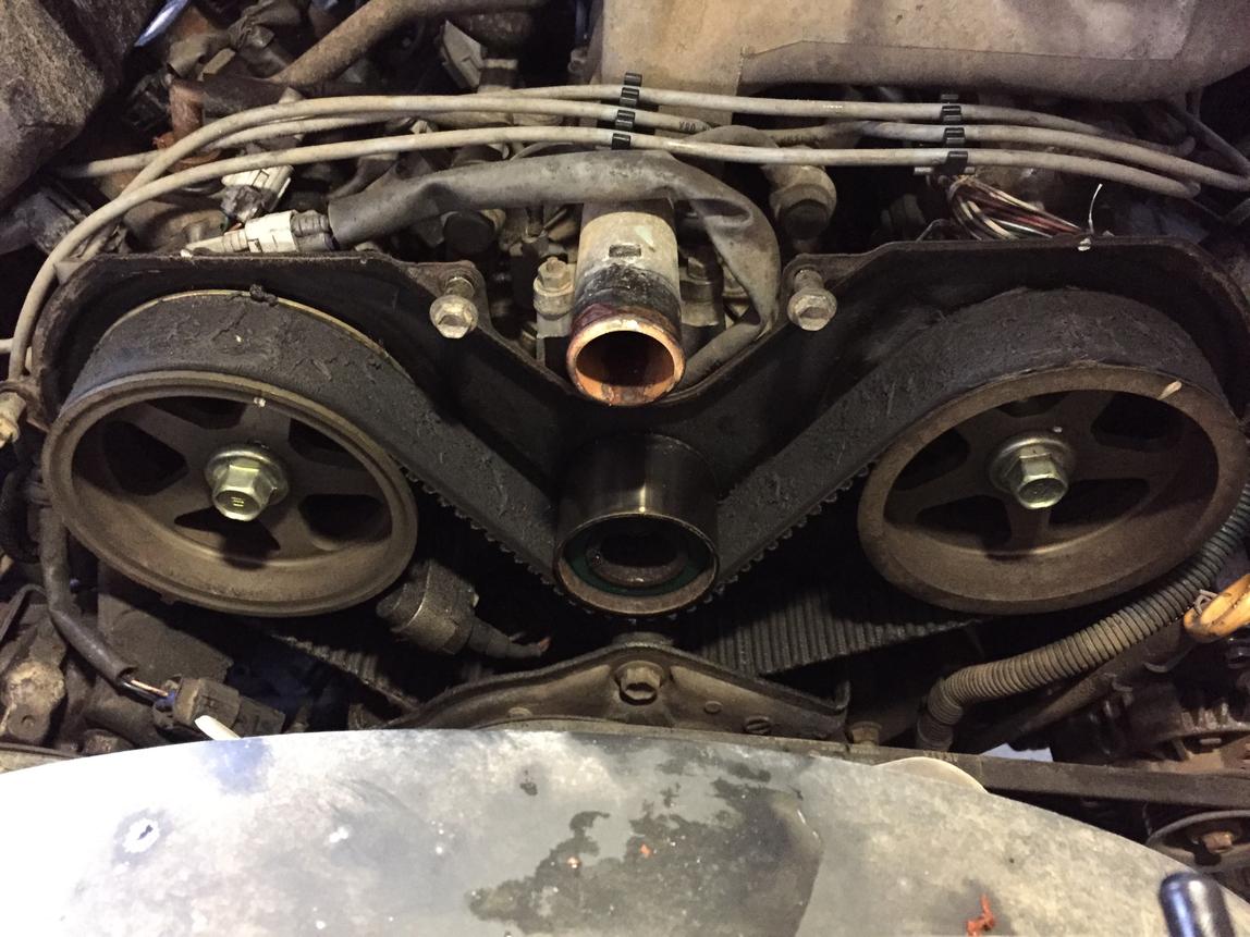

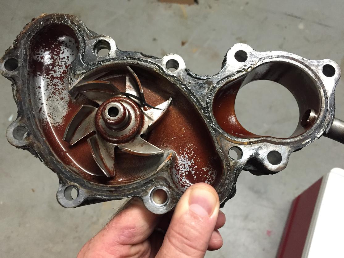

Update
Water pump blades were chewing into the side...bearings
Timing belt....what a mess. Maybe original
The above pic is a clear reason why almost all manufacturers use chains now and no more timing belts.
Yea, I'd have to say both are original. It looks like the belt caught fire and kept on going or just got chewed up with time.
