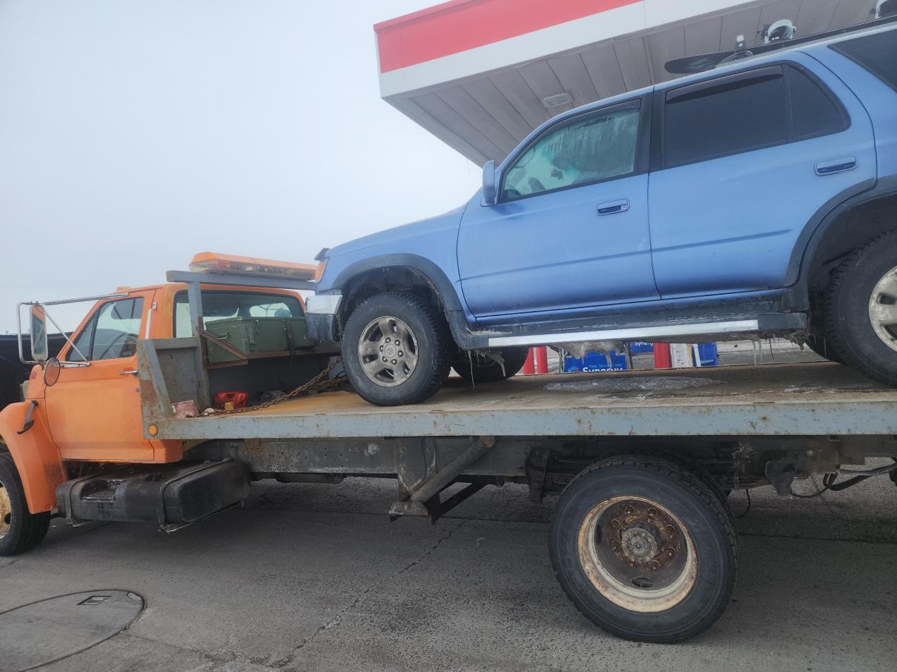

I just sold my 99 4Runner SR5 to my friend/coworker/neighbor. It's up to about 234K and I replaced the timing belt at 220K in May '21. Before that the sticker said it was done at 137K.
After two weeks of hearing about how much he loved the ride, he called me yesterday from the side of the road on the way back from a ski trip 3 hours away. He told me the timing belt snapped. Today he had it towed back to our maintenance shop and I saw it for myself and couldn't believe it.
When I replaced the belt less than two years ago I had the help of someone who was replacing his TB for the third time right next to mine. He finished about 3 hours before me and was able to assist with pretty much everything after getting the cover off so I felt pretty confident that it was done right. When I told him about the failure he basically said sometimes Shit Happens and stood by our install.
So tomorrow I will be helping my coworker replace the belt I just put in 14,000 miles ago and I'm wondering, did I do something wrong the first time? I couldn't find info on the kit I ordered, but I thought I got quality parts.
I drove that thing for 9 years and never got stranded anywhere ever. He's had it for two weeks and is probably really hating his choice right now, so hopefully we can get it rolling again.
