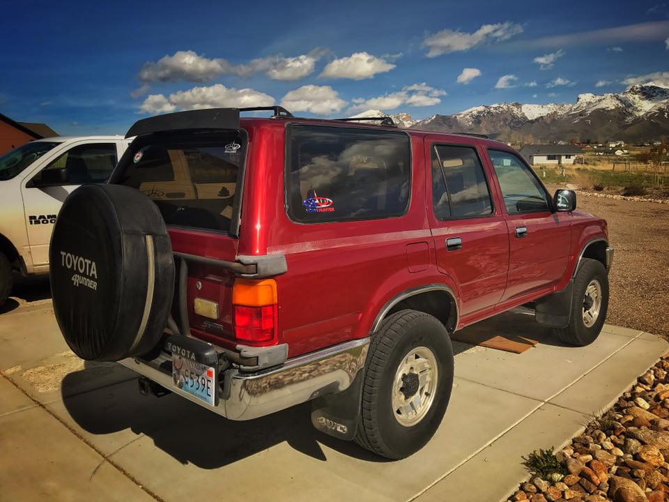

People here have retrofitted 2nd gen ones that were available in the US onto their 3rd gens. I think the years to look for are 90-91 that had the option of a swingout tire carrier. [MENTION=83502]Kryptoroxx[/MENTION] did it and has a thread somewhere.
My ears were burning! I do indeed have the 2nd Gen Retrofit.
Honestly I got everything out of the pick and pull for 14 bucks IIRC.
As far as the retrofit goes it is not impossible because it still works great on my rig. No jiggles, no warps in the body panel, and nothing has come loose. I drive 4-6 miles of dirt road with washboard every day. It's on there pretty good.
Here's a direct link to the tire carrier build. Lots of pics to help out. Best of luck. Make sure that you really want to do this. There's no real going back once you start it but I think it is very worthwhile.

I have a JDM 3rd Gen with the swing out carrier. You'll need the reinforced rear quarter which has the holes tapped for the M8 bolts. Easy way to see if you have this is to pull the trim panel on the left hand (passenger side on a US vehicle) and look in the quarter. If you don't see the reinforcement then you'll have to do some fabrication I suppose.
