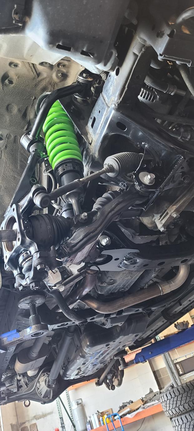

Usually I only get one when I change suspension components or like a steering rack. I do have total chaos gussets around my cam tabs so it’s unlikely my alignment will get knocked out even with rough off roading.
