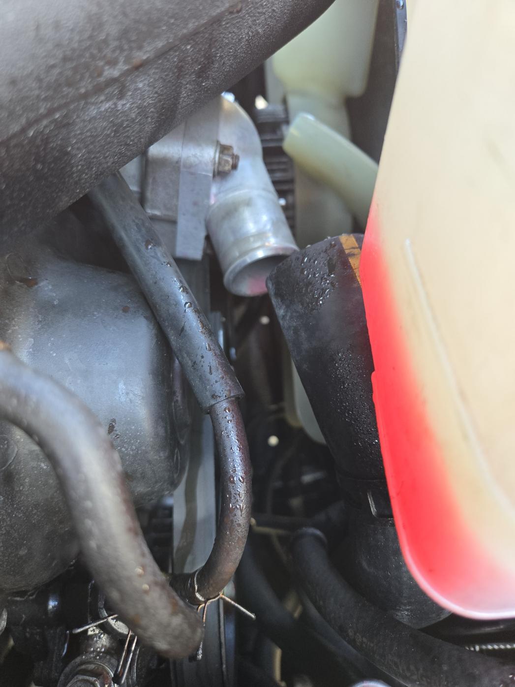

Hi all, last week I got screwed by my local toyota dealer. Here's the story, it may be long. I was doing an intake gasket and 8 injectors ( leave that story for another day). While it was apart I decided to do the bad timing belt pulley as it was noisy. During the removal the cams moved, I thought I got them back in time but I didn't. So I sent it to the dealer about 2 miles from me. They retimed it, I picked it up a day later drove home and parked it. Went out the next day and found antifreeze on the ground and all over the engine compartment. Looked for the culprit and found the right side rad hose off and the clamp moved down the hose. Called the shop and they sent a tech to my house. We put in about 1 gallon in and waited for the thermostat to open, when it did, it came back out like a geyser. Shut it off and toyota called a tow and picked it up. They did a compression test on all cylinders and all were within spec, all but one ranged between 190-200 psi. # 6 was 170. So they said all ok and had me pick it up. I came home and did my own tests. I did 2 cooling system checks. First test went from 16 psi to 5 in about an hour, 2nd test went from 16psi to 8 in about 1/2 hour. Then I pulled the plugs, bank 1 was burning fine, bank 2 the insulators were all white. That confirmed I had a bad head gasket. The engine is also knocking. So I discussed this with the service Mgr. He straight out said he will not put another engine in. Then w/o using exact words he said it was my fault that i didn't check the temp guage in the 2 mile drive. Called corporate, and was told that they were going to agree with the shop. WTF!!!! in the mean time I can't drive it.

I've already contacted my lawyer and I'm also considering blowing up social media on this. BTW i have pics of the hose off and the compression test being done.

After they fixed the timing they put it outside and let it run for 2 hours with the hose unattached. They even wrote on the invoice they let it run that long. I've got so much let's say evidence that they screwed this up. On top of all this they charged me over 800.00 to fix the timing.

Second, that picture, I assume, is taken from home. They would argue that you disconnected the hose yourself and that it was attached when you drove off the lot.

They already did that but I countered with two things, 1 - why would I do a TB, all the TB pulleys, water pump, fan holder, starter, 8 injectors, crossover gaskets, airpump hose, intake gaskets, hardware etc.. and then sabotage my engine. A few parts even came from them and then spend roughly 800.00 to fix it. Plus all the AF spray all over the engine, it could not have gotten that hot yet in a roughly 2 mile trip. It was there prior to me picking it up. As soon as I brought that up the serv Mgr. Got quiet.

Yes, your odometer only ticked two miles. Can you prove that you did not idle the engine for a time before or after driving your two miles to get the engine up to temp? The dealership wrote down on the paperwork it idled your vehicle for two hours. That could be argued that your vehicle was in perfect operating condition when they handed you the keys and whatever happened happened outside of their control.
