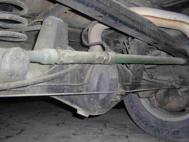

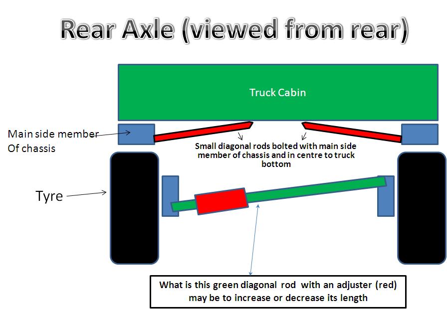

In rear suspension, along the axle, it has a diagonal rod (green color) with an adjuster may be to increase or decrease its length.

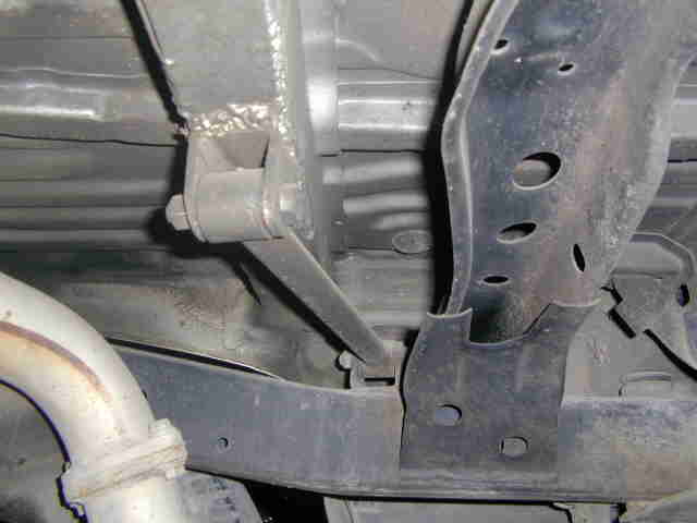

It has two brackets welded at the bottom of the cabin with a rod bolted in each. The other end of these rods is bolted to the side member of the chassis.

a. What is this diagonal rod and why it has an adjuster.
b. What are these short rods doing.
c. Is the quality of welding OK. The finish is not clean, Japaneses mod may be such

Left Rear hub, Notice the green diagonal bar bolted. Sorry for poor pic quality

In the last pic it looks like a coil spring ?
If the rear has coil spring suspension the green bar would make sense if it went from the axle on one side to the frame on the other. I can't think of what it would be for running from one side of the axle to the other.
If you can post more pics of the rear axle and suspension I might be able to tell more.
As for the bars from body floor to frame, I don't know.
Those bars from body to frame.
Welds don't look to good.
Looks like they burned through the thin body sheet metal on the one side.
Also, one is round and the other is flat ? (looks like a leaf spring)

Green rod is the left end of the rod, other end is also bolted with the axle but slightly hgher. Zeal PRO-STAFF site is in japanese it also has the pics of the similar lift accessories.

I would get those welds looked at . It does not look like a good job of welding at all , just to be safe.

Same welded rod. Sort of trailing rod? what could be its function?

I am pretty sure that Green Rod is an "Adjustable Pan-hard bar". its adjustable to line up the rear end. helps to keep from Dog tracking. When a "car" is lowered or raised, the back in shifts left or right, and the adjustable part compensates for that movement.
Look at the drawing again.
It goes from one side of the axle to the other.
A pan-hard rod goes from one side of the axle to the frame on the other side.
I'm not sure that his little sketch is drawn right. Looking at the actual photograph it looks like axle on one end and frame/upper bar on the other.
