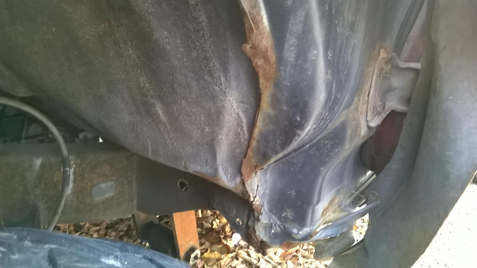

Finally, pics:

Firewall and fender trimming:
[/URL]~original[/IMG]
Closeup of firewall. I know it's kind of hard to see the actual seam:
