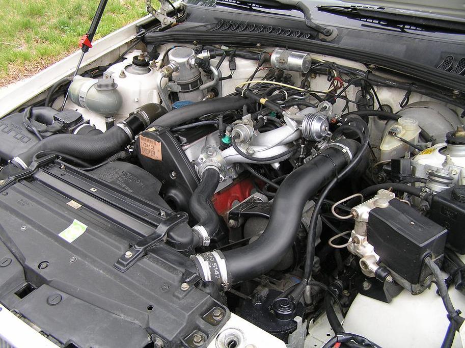

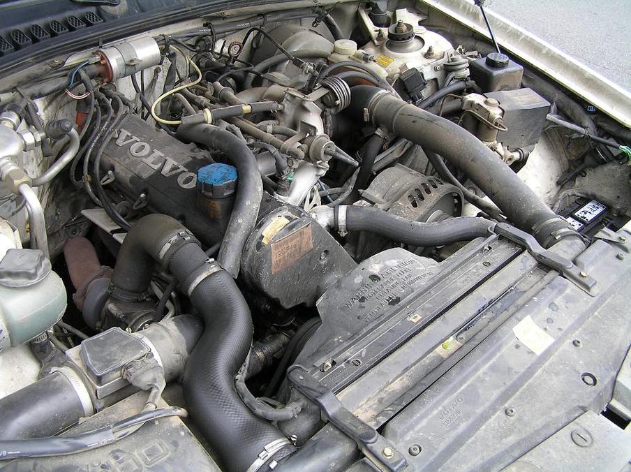

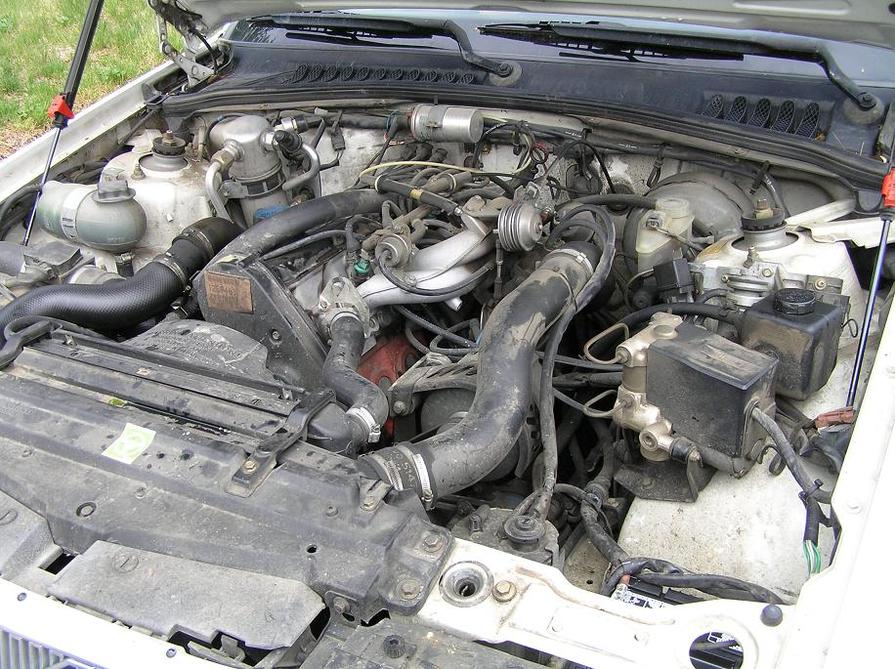

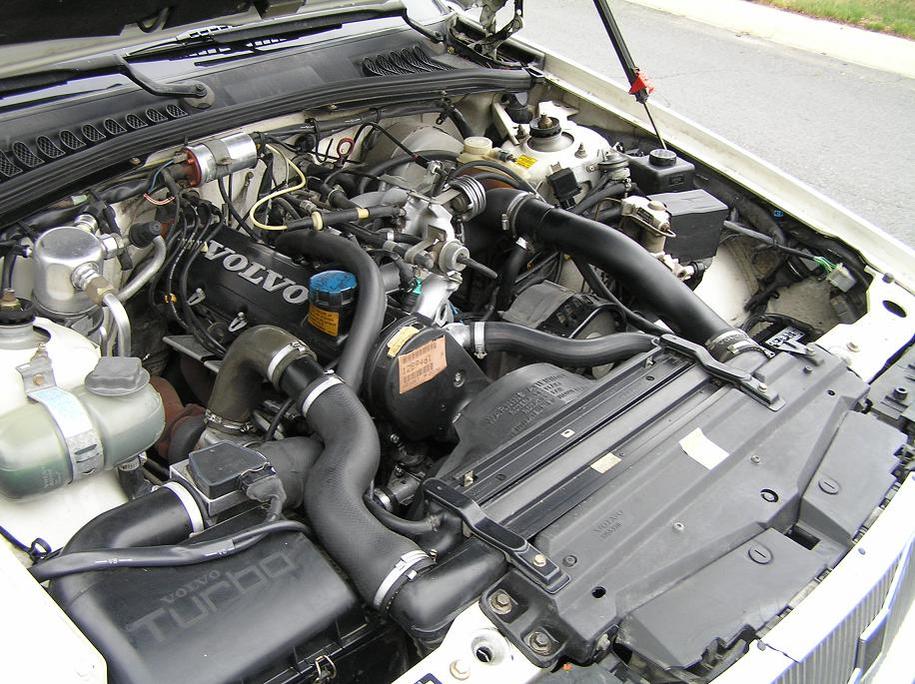

Ancient pictures, but this was done in about twenty minutes with "Simple Green" and a garden hose with a spray nozzle. I cover the alternator and the distributor/ignition box in aluminum foil:
Before:
AFTER:
