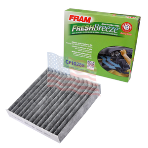

And the cabin air filter... buy what you want, but make sure to get the one with the charcoal filter as part of it. That helps with smells in your ride.
I change both of mine yearly, unless I know I've been in some real dirty air.
I use this cabin air filter. From Amazon.
EPAuto CP285 (CF10285) Toyota/Lexus/Scion/Subaru Premium Cabin Air Filter includes Activated Carbon
Correct me if wrong, but I thought only air form the outside went through the cabin filter, not recirculated air...?

Cabin filter... much less critical, but I did like the ones with activated charcoal.
I never really thought about that, but what you said makes sense. I even googled it a bit. Most of the Toyota dealers talk about filtering the air coming in, and the charcoal helping with the odors coming in. So, I was kinda right about the smell in your vehicle, but not the ones from the burger and fries left in the back seat :zoom:
