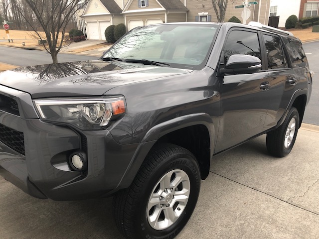

I am pretty sure it doesn't have KDSS but its really tall. Taller than the 2WD versions I test drove

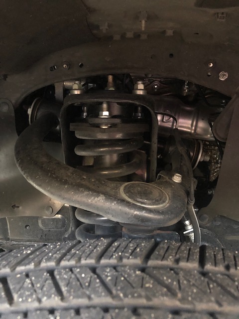

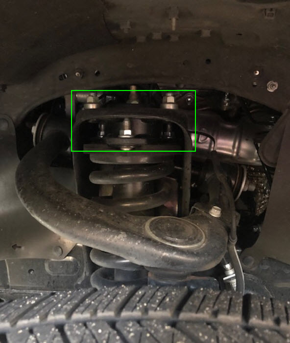

It has a leveling kit up front which is the spacer you see on top of the front coilover. Looks like maybe a 1.5" or 2" lift spacer. Really can't tell if they did anything in the back but if they did it's like a spacer on top of the stock coil. Nothing wrong with this system even though people bash them every day. Is it the best? Absolutely not but for a street queen or mild weekend wheeling, it's just fine. Now throw some real tires under it!

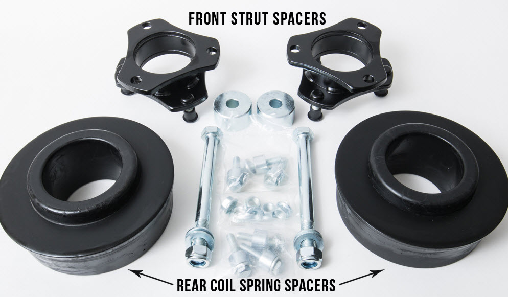

I'm going to guess it's a procomp 3/2" level. The back looks pretty high too
Welcome to the 5th gen section. Looks very new underneath. Congrats!
