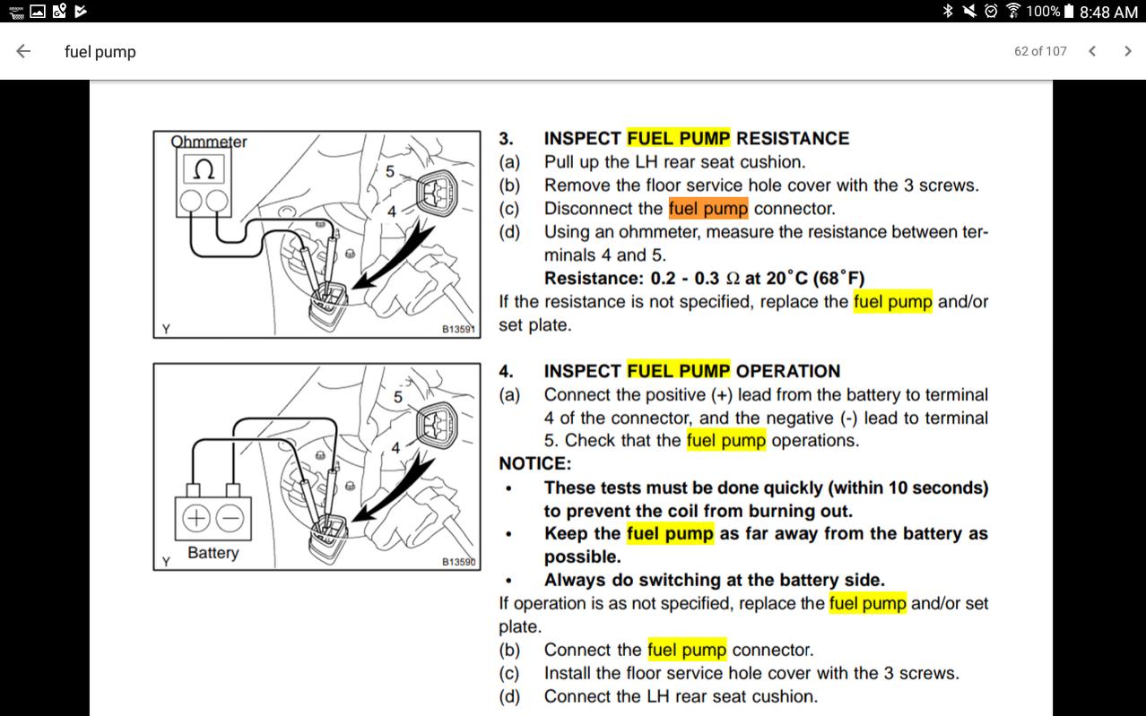

you can test the fuel pump, also [MENTION=147235]Renegade_Medic[/MENTION] has a good write up with pics on his build thread.
