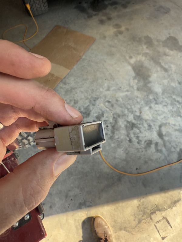

Does anybody know what this even is?
Has two wire connector, colors are RED/BLACK and WHITE/BLACK.
I'm not seeing it in my wiring diagrams.
ChatGPT seems to think it's a resistor housing for some dummy plug. I'm wondering if I can run the truck without it.
The answer is yes: the truck runs fine without it. Thank god because the wiring is SCREWED on both ends; at the harness and at the connector. No CEL codes.

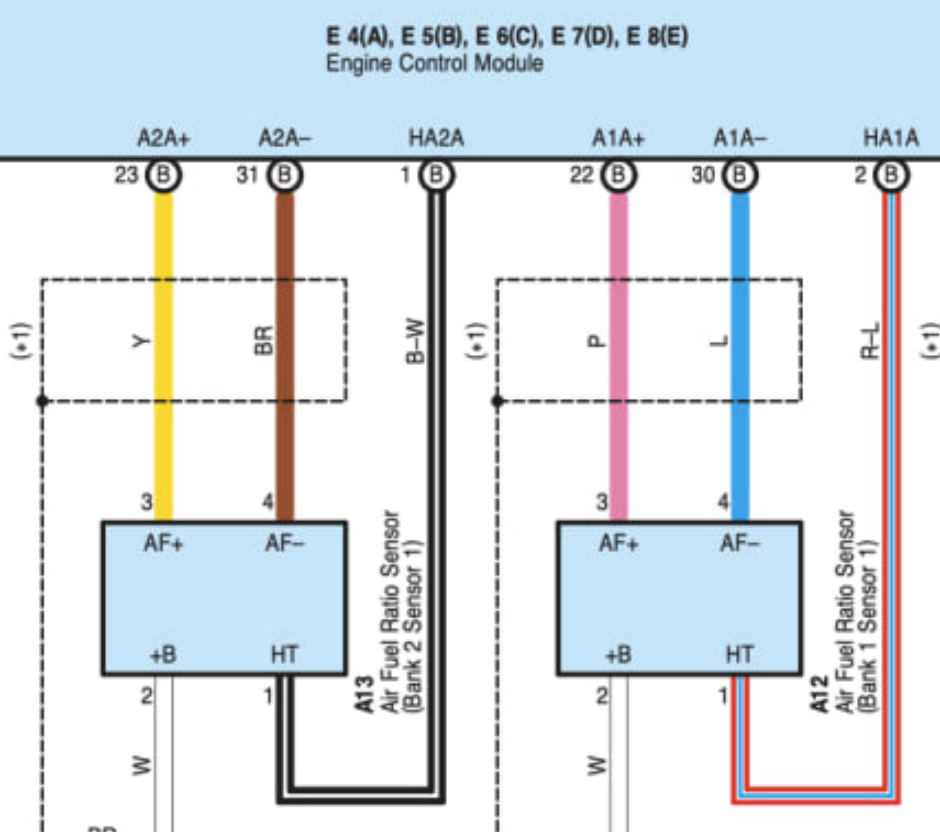

Saga not quite over. I drove it two times on short trips to test it and then on a third trip of about 20 miles I got a CEL:
P0031 - Oxygen (A/F) Sensor Heater Control Circuit Low (Bank 1 Sensor 1)
Almost certainly another wiring issue. I tried resetting the CEL and it came back instantly which is interesting--it implies this issue just popped up after a few miles so maybe new mouse damage? IDK.
Oh so just to double check and spell this out if anyone knows:
Bank 1, Sensor 1 on a 1GR-FE is going to be a o2 sensor that runs from the passenger-side cat, into a wiring harness on top of the motor, and then following that into the ECU on the glovebox side of the interior?
Do I have this right?
I think o2 sensor wiring goes to the engine bay fuse box as well.
Doesn't look like it, but maybe the W wire. Guessing it's likely going to a ground though:

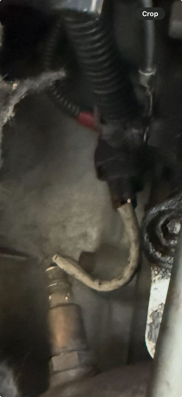

So this morning I pulled the intake so I can lay eyes on the o2 sensor wiring. I will never understand why a manufacturer would run wiring behind an engine when it could just run it along the top of the firewall.
From the o2 sensor to the connector looks fine, and from the connector to the harness also looks fine. You can't lay eyes on the entire run, but feeling by hand I could tell there are no breaks:
(the angle of the wire going into the sensor is a little weird but seems fine and I wasn't able to detect any breaks or damage)
Not finding anything I put the intake back on the truck and started it up and reset the CEL.
I proceeded to take two 10-mile trips at 60mph. The truck drove perfectly fine and the CEL did not come back.
WTF.

Got most things back together, leaving the intake manifold. I have two wiring repairs to do on that. One looks easy and the other not so much as the connector broke off AT the connector.
That is a noise filter. You will have one for each bank.
