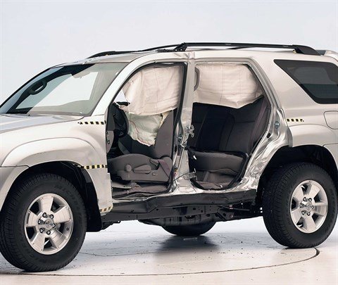

I have an 07 limited with side curtain airbags. My leather seats also have the small tag. However when I recovered my front passenger seat I do not recall seeing the airbag and for sure there was no pouch in the cover like I've seen on youtube. So what gives? Is there an airbag in there or is side curtain only deployed from the pillars?
Thanks
I thought the airbag was above the door frame but the tag to indicate an airbag was on the seat

So if it's under the foam is there any reason to be concerned about installing a new cover? I only ask because some covers say the "airbag pouch" should be transferred by a professional but that looks like the ones that are stored in a pouch in the cover.

the seat air bag isn't in the bottom portion, it's in the side bolster of the upper half in the general area of where your factory cover reads the SRS tag. When you do seat re-covers you don't mess with the air bag, but one thing to be cautious of is making sure your new covers are rated for the bag. It basically (from what I gather) has a stitched seam that will give way if the air bag deploys.
What I found with my cheaper covers is that I didn't have the same additional tab from the seat cover that runs and bolts to the back of the seat frame that is meant to hold the seat cover taught while the stitching gives way. I installed it anyway :der:
