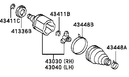

Ok, it may be this dust seal. 43501K and 43502K here:
Ta5G-2nX54QIPOaZOvNy3Mhyicf9W78Lv-Irt_kcex8kbc5tgP55qTrQbV9YfNheG-kdmG4GCxNEFTAh87ErKInnjZNDBWm3S6ijmXg4AhOEPXj5irmOSEc9TzjFr6H3G4TSfLFfqg=w400
McGeorge sells them for $37 each. Yikes. The bonfire of money continues.
If anyone can provide feedback on if I am right on this part, please chime in..!

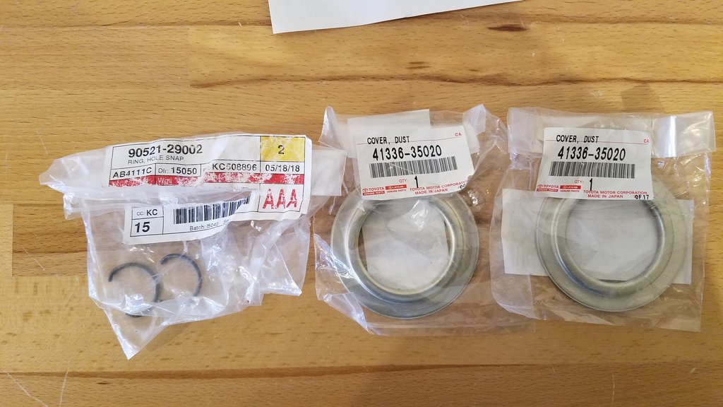

I had some inboard seals lying around here's a pic with part num. Also the snap rings.
Part number for the seal on the outboard end should be 90304-80002.
Excellent, thank you. I'll also order the snap rings, forgot about that. Interestingly, those snap rings say they don't fit my 2002 Sr5. I'll find the right ones.
Also thank you for the confirmation of that seal too.. While I bet my olds are ok, but may as well do it "while I'm in there".
