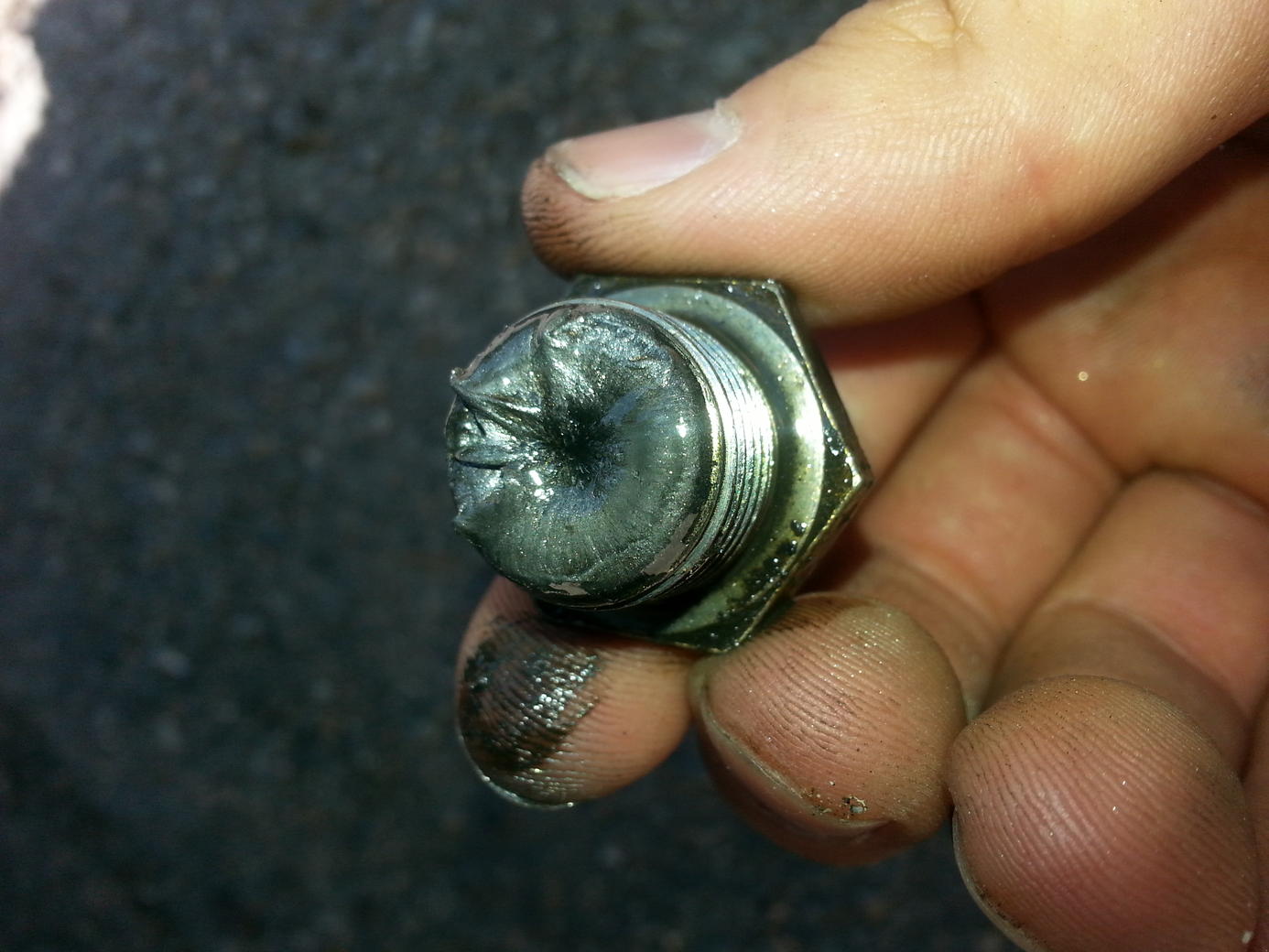

I drained my rear diff fluid and this liquid was all over the bolt
I hope this is normal..

That bolt is magnetic — it's supposed to catch that stuff.
I haven't pulled enough to know whether your has excessive buildup or not, but mine had some as well when I swapped fluids last. Some amount is to be expected though.
That looks normal to me. I just drained mine and the fluid was pretty dark and had a similar amount of metallic sludge on it.
The key is if there are metal chunks or shavings. If it is super fine metallic sludge like in that picture, that is totally normal. Fill it back up and call it a day...

Looks like about what i had on my drain plug and on my friends 99 that we recently did a drain and fill on...maybe not quite as much of the thick paste but kinda close.

the fluid still looked kinda clean pouring out I was surprised.
thanks for assuring me that this is normal
I can put my mine at ease now
I slaped everything back together
