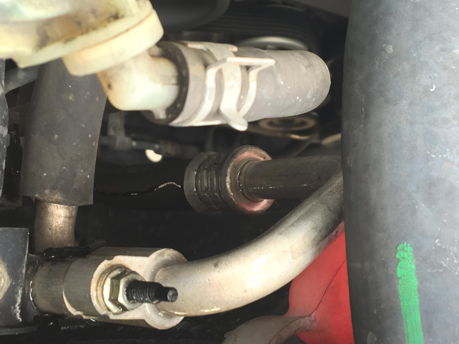

Last weekend I noticed that my coolant reservoir was near empty. I went down to the Toyota dealership on Sunday and bought some coolant to refill the reservoir. There are no apparent leaks in the radiator, but I did notice this small trickle in a line next to the reservoir. [MENTION=66389]BlackWorksInc[/MENTION] would you mind taking a look at this picture to give your diagnosis?

Judging by its location, I'd say the leak is coming from under the coolant hose with green stripe. Hose or radiator neck issue...hopefully just the hose.
Nope checked under the hose and it is perfectly dry. Are these hard lines for the A/C refrigerant and could it just be condensation coming off of the lines? I noticed the drips only come when the A/C is on. You'll notice the line in the foreground also has some fluid around it as well. Doesn't smell like coolant.
That air conditioning line will get very cold, with how humid it is in Florida you'll see a lot of condensation on the low pressure lines forming.
As for the coolant mysteriously dissapearing with no signs of a leak, how crusty does the radiator cap look? I could be going bad and letting the coolant boil off.

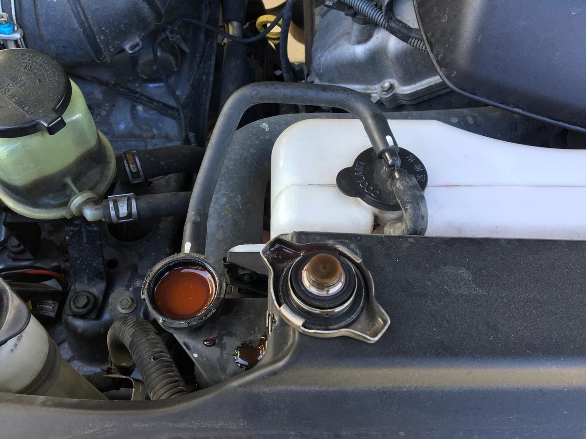

Here is a picture of my radiator cap. Doesn't look crusty at all.

OP, what year is your 4Runner? Your mileage is typical of the appearance of HG problems in the 05 and earlier 4th gen v6s, but some of the 06's with early build dates also can have HG problems, but no reason to jump to conclusions with no other symptoms. Also, is it just me but in the pic your coolant doesn't look very "pink". In fact it kind of has a rusty color? When was the last time the coolant was changed?
It is a 2007, so a few years after the HG debacle. I have never changed the coolant, but it is on the list along with changing the tranny fluid for sure.
Well good if it's a 2007 then it's not likely to be a HG. For the record, at 138K miles you're almost at the mileage (150K) where your coolant should have been changed TWICE by now, once by 100K then again 50K miles later according to Toyota. I would change the coolant to fresh "pink" long-life asap. You might have some corrosion in your system with that old coolant , but at the very least, if you have any leaks, or a weeping water pump, the bright pink coolant will make it easier to spot.
