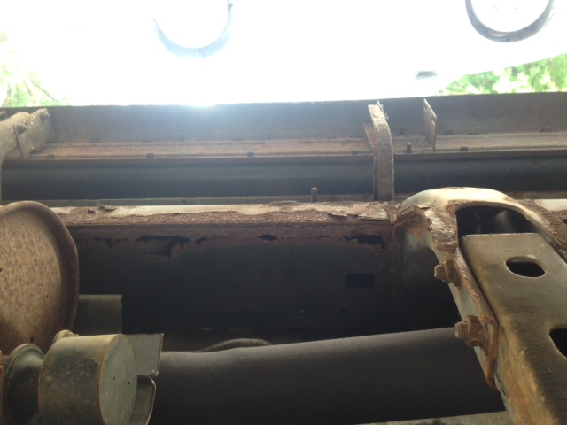

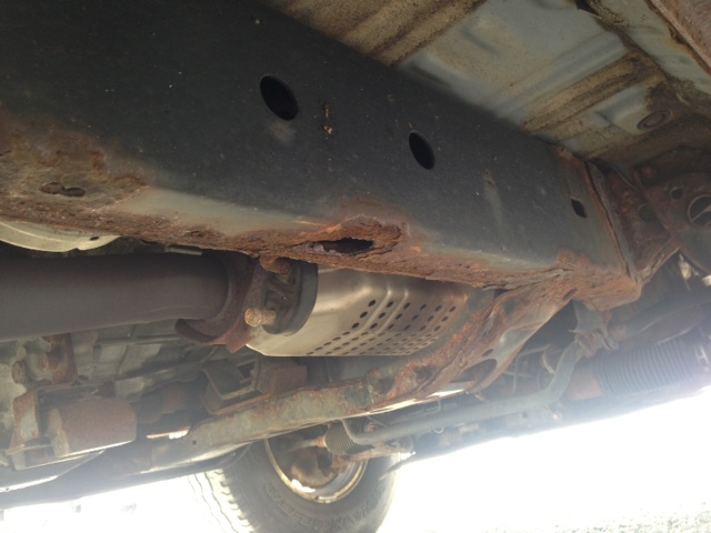

is this repairable or just say away from buying
cahil
4runner i want to buy is clean on the outside
looks like this underneath..
what should i do..
buy or stay far far away..
..cahil

Just for the fun of it, what's he asking? I'd buy it for $1000 tops and part it out if anything, then scrap the rest. I would also not feel safe driving that thing down the street.
it would have to be a hell of a good deal.
then as said, part it out, or swap in a good frame.

I've seen it before. a good friend of mine did a few frame swaps just like that. its a factory recall. look into it a little. not sure if toyota still supports this recall....

Box Frames tend to rot out. For $4k on a 2000 4runner i would bet that the dealer knew about the frame rot before you asked.
If you are willing to travel that far, just buy one in arizona/texas, or any other southern states that do not see snow and salt. I bought my 4x4 99 5 Speed in AZ for less than that truck is listed for, so deals are out there. I like to stay away from dealer when buying used cars, and i really only use craigslist to buy cars. Read the buyers guide, it will give you more things to look for and better ways to find more trucks.
Frame rust recall is for Tacomas.
My 83 had much worse frame rust and it was still OK to drive for a long while.
I finally swapped a new frame under it, but I wouldn't buy one like that.
One frame swap is enough for me.
Former Toyota tech here, recall is also for Sequoias and Tundras not 4Runners.
Keep your eyes peeled for gems, they come up every once in a while. That's how I got my 4Runner.
Rust like that underneath? RUUUUNNN! After having one with some pretty bad rust before (but nothing like what you showed), I made up my mind to only consider those with little or no rust underneath--after all, that's what's holding everything together, and what mods get bolted or welded to.
