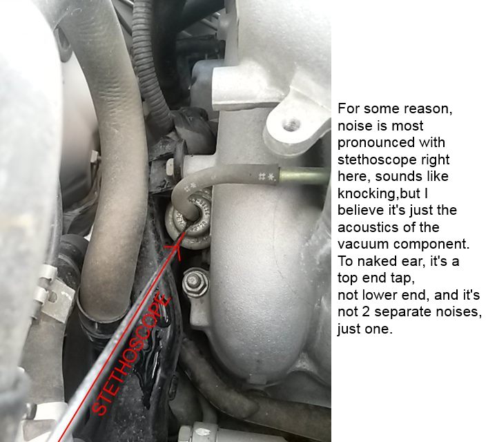

30 degrees out this morning idling, it took 10 minutes Before any noise was audible. With stethoscope it was slightly more noticeable than other cylinders before that. The tapping came after a bit and then it also got quieter, barely noticeable to naked ear, at idle I guess it comes and goes, so maybe a simple flush will help. Sound was much more pronounced yesterday after driving a few miles (original soundclip), but was definitely steady at that time, not going away. Vehicle is new to me.
It may be a sign that the noise was most prominent when I placed 'scope on the little vacuum thing coming off the intake by firewall >plse. see photo. Placed there, it sounds almost like a knock, but I'm 98% sure that's the acoustics of that particular element but thought it interesting that it was so pronounced right there. The lower end sounds fine. And by ear, the sound is definitely an upper end tick which sounds quite close, not muffled, and not any lower octave knocking.

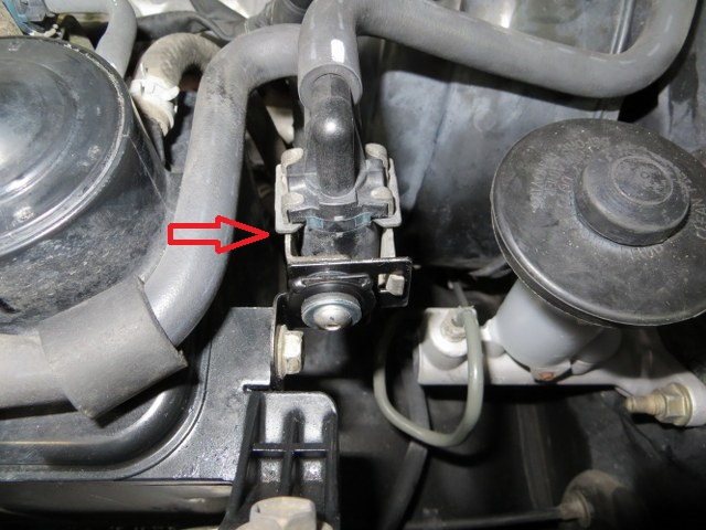

I have an obnoxious tap/click also - but its from the vacuum switching valve assembly. It seems to start making a racket after the engine is warmed up. You may try probing around the vapor/charcoal canister on the drivers side wheel-well with your stethoscope and see if anything there is contributing to your noise.
Thanks bugman, this sounds similar, mine makes the sound after warming up quite a bit also, and did you see the pic I posted above where it's the loudest (by using stethoscope) is the little vacuum thing coming right off the intake between the intake and fire wall, sounds like knocking in there. Can you elaborate on the vacuum switching assembly issue you had, what you tried/the possible fix, and was it similar to a valve tap in frequency,etc? I'm gonna look into it's location,etc. Thanks!
See pic below for vacuum switching valve. Not sure if this is a source of your noise, but its worth a check. (FYI the rubber isolator on mine was broken, which is why you will see a button head cap screw and a few rubber washers attaching it).
Mine is quite loud - I can hear it inside the cab. I have compared it to a friends 3.4, and his is significantly quieter. I can actually pinch the tubes with my fingers and "feel" the pulses. To the best of my knowledge these click audibly under normal operation. One of these days I will pull one from a junkyard and swap it to see if it makes a difference.
Thanks bugman for going to the trouble to post that pic. I'll let you know if mine makes any noise for reference.
