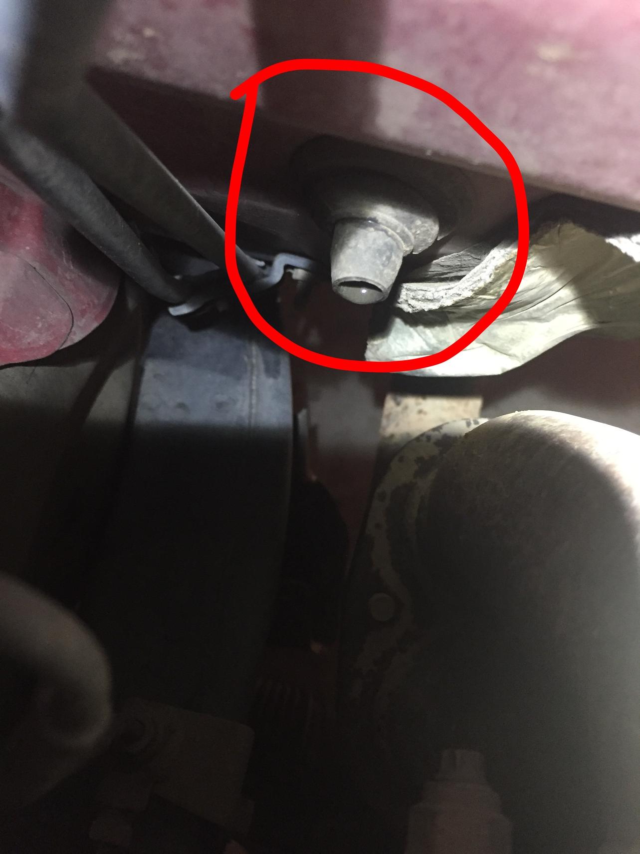

Howdy everybody! Please excuse my lack of knowledge, as I have just bought my 4Runner about 2 weeks ago. I have a 1998 3.4L V6 5 Speed. I noticed after I drove my 4Runner yesterday, that I had a decent sized puddle of water underneath my 4Runner. I checked out the water pump and it was not leaking from there. I finally found that it was coming out of the black drain(?) on the passenger side of the firewall. One of my friends said he is pretty certain that it is condensation from the A/C. But I just wanted to check to make sure it was the A/C and not something more serious.

If it's a puddle to the left of your front passenger tire then it's probably your A/C drain.
You could check by driving it without the A/C then park it for 10 minutes to see it there is no puddle.
btw it's not your ac condenser but the ac evaporator.

He didn't say it was the condenser. He said it was condensation...which it most definitely is.

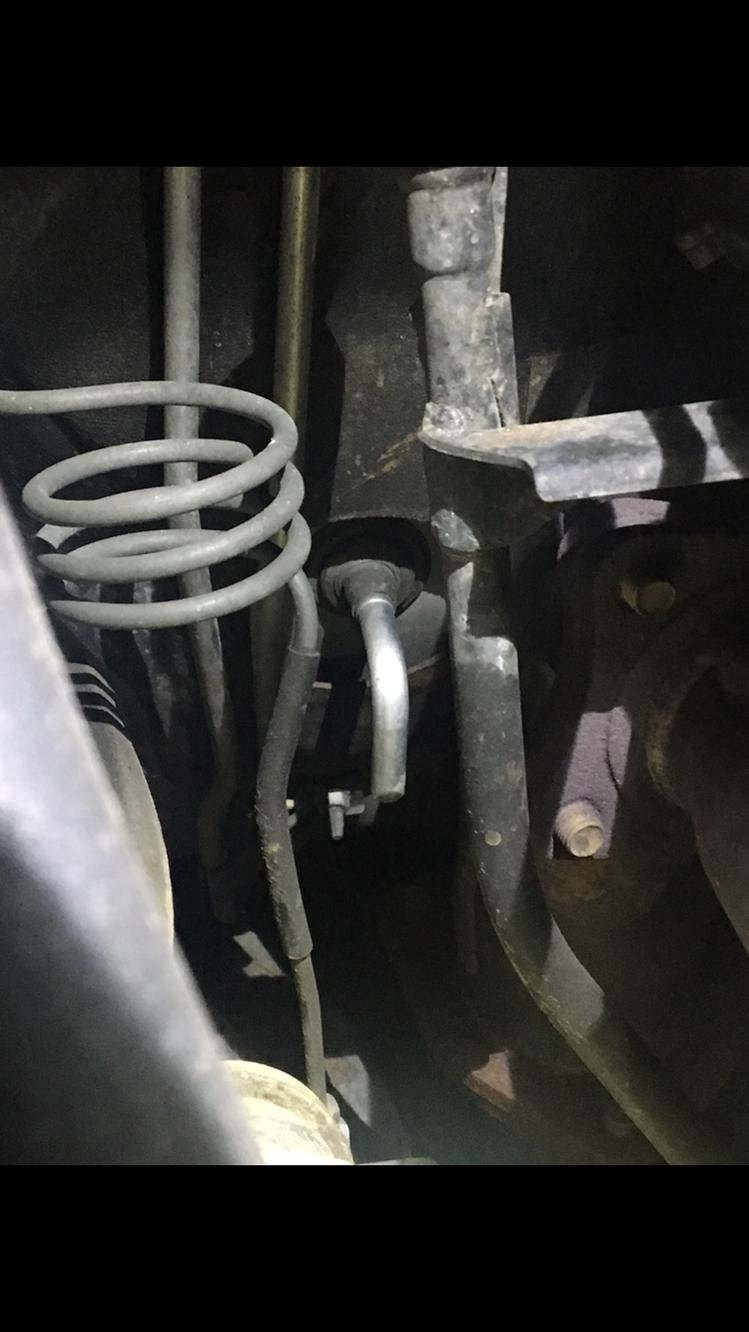

Looks like it... only thing that's different is that you don't have the metal elbow tube, mine has it but it seems flimsy so it could have just fallen out

positive, A/C drain. Mine is the same, without the metal extender (same as OP). You can use a thin rod to unblock it by there if it ever get blocked.
Without the metal tube, mine dripped directly on the sway bar link.
That's why I extended it down to the frame rail.
I'm pretty sure it is, my 96 3.4 5 speed has the same nipple drain thing and my dad told me it was the A/C drain. My truck also had a pool of water under it.
