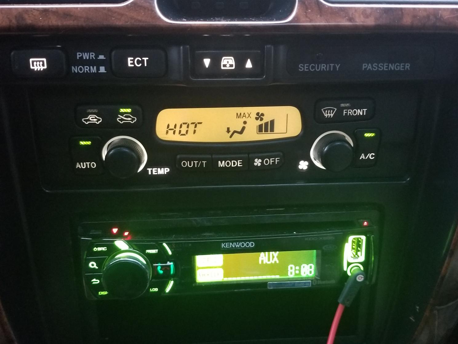

Is this the rear window button backlight bulb?
JZiggy
Senior Member
The one on the left. Is that it?
Replace them both and it should work. Especially if you are doing an LED upgrade. looks real good. Yes the one on the left is the rear window

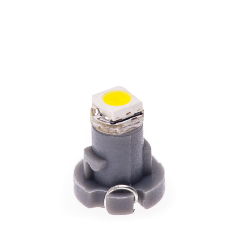

Do you have to take it apart to get to the bulb?
If led what size..I need to do the same thing.
I need to find the chart thread and Oder for my gauges also.
No disassemble, you grab the shank (ridge) on the back of the bulb with needle nose pliers then twist and pull - the bulb comes right out
I bought these from superbrightleds.com
Thanks. As I put more miles on me 'runner, I'm realizing how dark it is inside of this rig. Seriously considering throwing some LED luv into the cluster/HVAC controls. My old MK IV TDi Jetta had tiny red LEDS on each vent, just enough light to indicate where each vent physically was located. I'm thinking about attempting replicating something along those lines. Even my CRV has a few very small "ambient" LEDs.
interesting concept. Ambient leds. would make things a little cozier.
I still dig the green. My sonata has blue and it just isn't the Runner. :wow:
