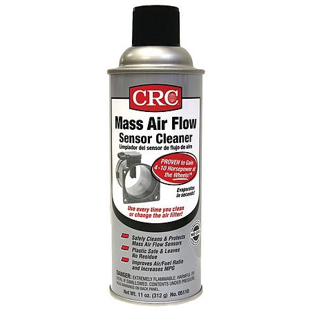

I cleaned my MAF sensor yesterday with cleaner i picked up from Advanced Auto. I also dropped both screws while putting the sensor back. Guess I was all thumbs yesterday…BUT was able to find 4mm x 10mm screws from Home Depot to replace them. Fingers crossed this will help my issue.
