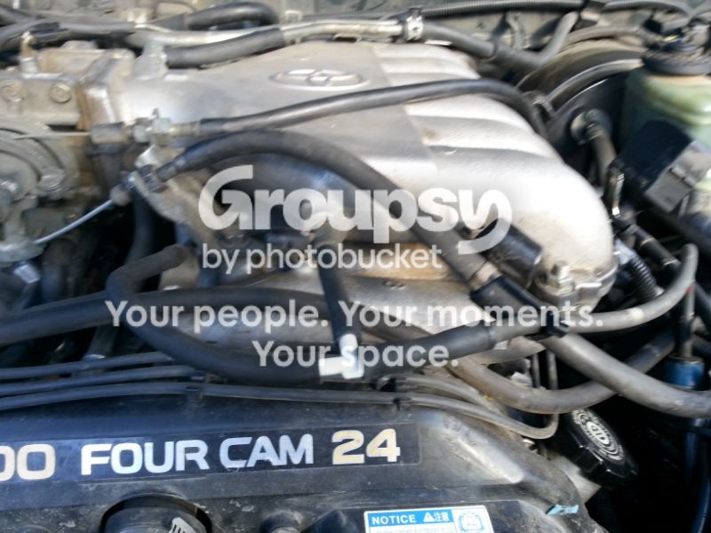

the hose that plugs into the air-box is in ruff shape, i just ran it up the nipple past the split end, and put a hose clamp on it:
ebf79cb2-d8cf-42ba-855c-c932c607b63d_zps5a938ea9.jpg~original
i followed a write up that replaces the vacuum line off the silencer box, with this one here:
T_zps6d82575e.jpg~original

I'm going to take Wilson's advice, and go hunting for vacuum leaks... not sure where to start, but will begin with the two pipes i messed with, and then onto the throttle body. Then a smoke test with a cigar if push comes to shove, not sure i want to shove a vacuum line in my mouth, but if push comes to shove!
:tape:
I would say a vacuum leak. Your lines look pretty rough. I would buy an assortment of vacuum lines and replace them all. That's what I did and it looks a lot better too.
HOORAY!!!! the vacuum line to the 'Throttle opener' (at least that's what the interweb calls it) was unplugged here:
Unplugged_zps0c16666b.jpg~original
I drove around the block and no code's.... I can't thank you all enough for the the help!
like Wilson said! check, re-check, tipple check! and if i may add one, lightly tug on the lines to see if it's just resting against the plug! :ybrick:

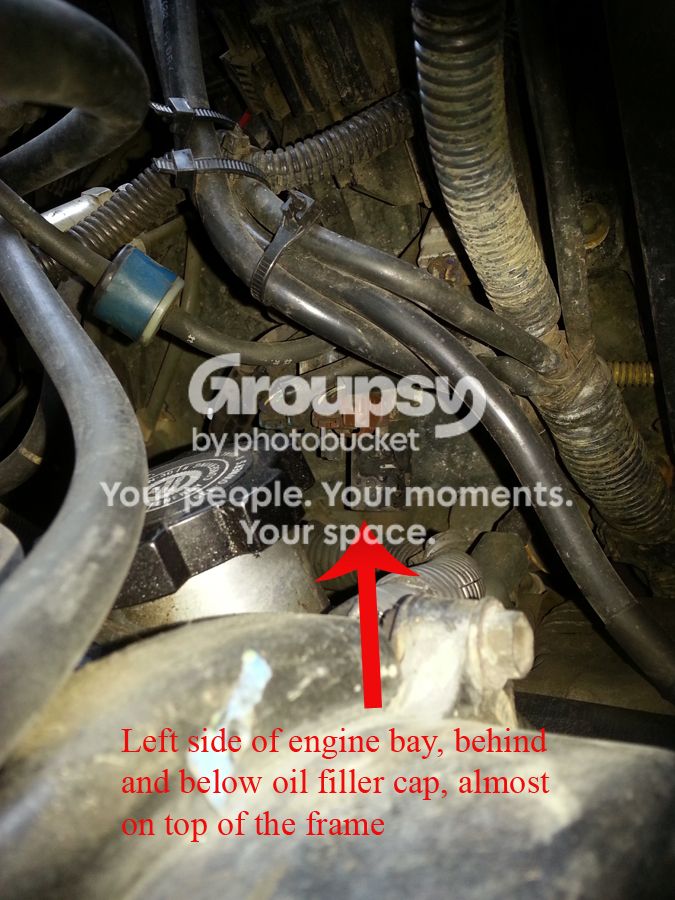

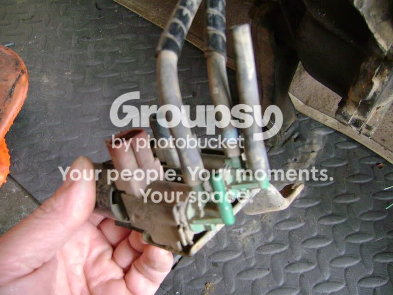

So i was poking around my vacuum system today (planning on cleaning up my birds nest of battery cables) and i noticed this do-hicky:
4wdsolenoid.jpg~original
appears to be smashed and missing the back portion, and the front portion to be horribly mangled..... it's called a VSV for the 4wd system (from what i can find in pictures on the forum) i don't have any issues getting her into / out of 4wd, but have received the P171 code again a few times over the past week, so i know i do have another vac leak.... somewhere..... should i consider this a possible source of the leak since it's so mangled, even though i don't have troubles with the 4wd?
thanks for the advice guys!

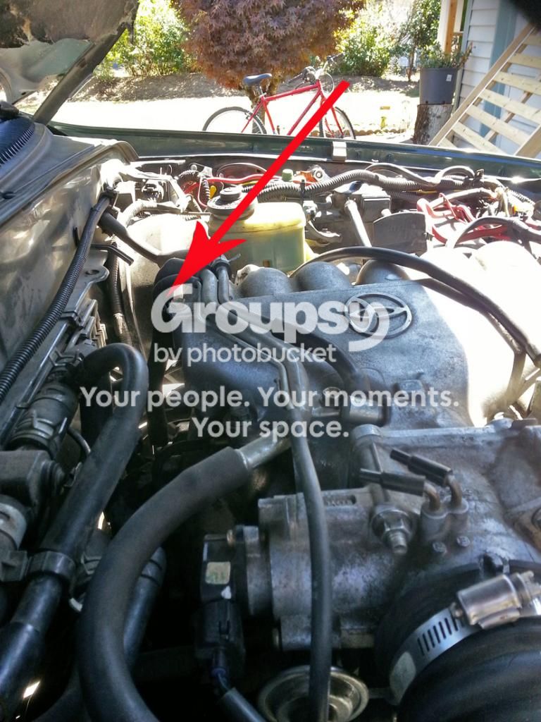

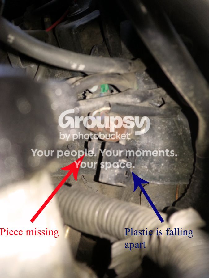

here's the mystery part:
Overview
location_zps8b0e9d18.jpg~original
Close up
Part_zpsb182d1d7.jpg~original
Any input is appreciated... thanks again!
