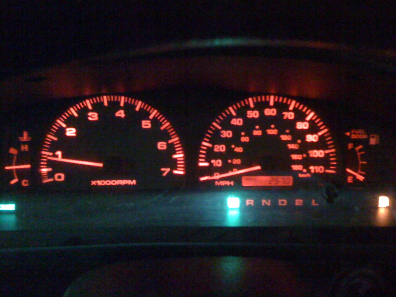

xskydivingdudex: there are a couple hotspots, but nothing than any of my passengers noticed. Only me and my brother who also has a 4Runner (his dash is blue and white as well) could tell. Superbrightleds.com is the site i used, they are pretty quick and fairly cheap
I want to see this pic too. I miss the amber lights from my 2001 tacoma. Just seems like so much work..
Maybe i'll do it when I finally get around to installing my darn field monitor.
ok, sorry guys, i semi lied. The red dash was from my first 4Runner, a desert dune base model. I sold that just recently and now have a Imperial Jade SR5. the new one is all stock still, but I'm looking to do mods while I have the time. I'm a senior in high school, so I can't afford too much haha. but a LED dash conversion is only about $30-$40

That does look good, has me seriously considering this. A bit bright for me though, I guess that is what the dimmer nob is for.

It actually isn't too bright. That was taken with my iPhone, so it's hard to judge real quality. I loved it, I thought it was much easier on eyes during long night driving.
