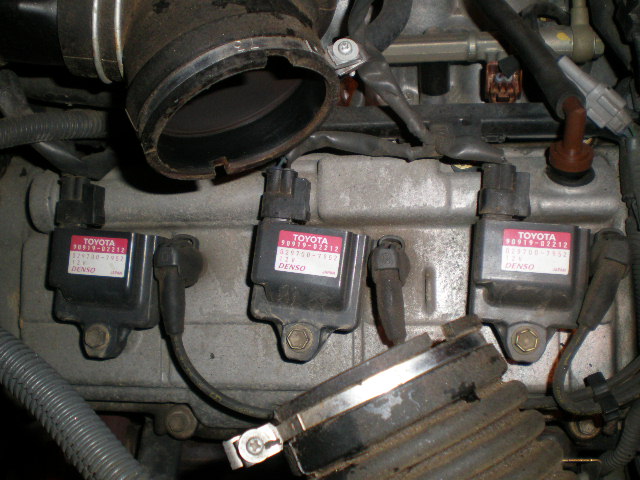

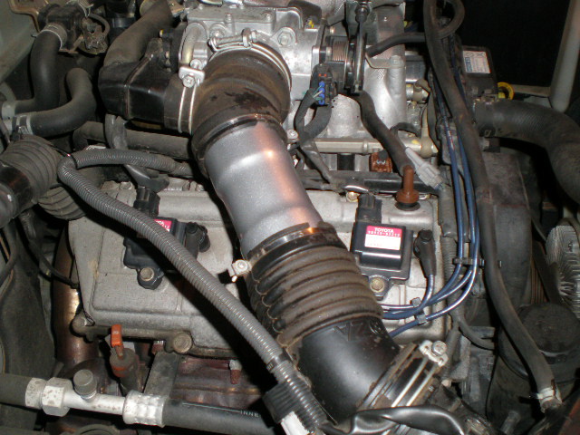

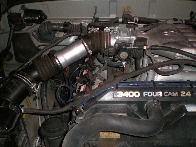

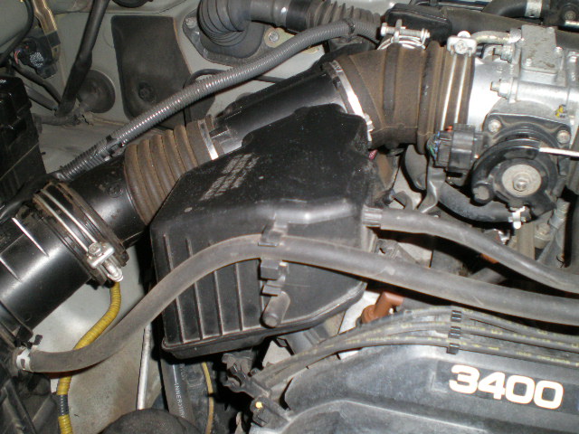

So last weekend I posted a small write up of what I did to my airbox and this weekend I decided I'd change out my plugs and wires, and being you have to pull the ISR off to do it, I decided I go ahead and do this mod.
I was able to score a 5 5/8" long piece of pipe from a local muffler shop and had them bell the ends to just slightly over 2 5/8" diameter. Their cuts were a little rough, so I borrowed a neighbors bench grinder and smoothed the edges out. Then, using some wheel and rim spray paint that i'd purchased to repaint my center caps with, I painted the piece to give it a nice silver finish and hopefully prevent any rusting and add some heat protectant.
There are some nice ISR mod threads already written so I won't bore anyone with all the details of another, but after I changed out my plugs with some nice NGK's, and a new set of NAPA oem plug wires, I installed my newly painted intake pipe, pulled and reset the EFI fuse, and started the old girl up. I haven't had a chance to drive her yet, but from just giving it some gas in the garage I can't tell any real noise difference, although as my stepdad pointed out, "it does sound strong", for what thats worth. Looking forward to taking her for a nice Sunday ride tomorrow morning :D
Here's some pics:
