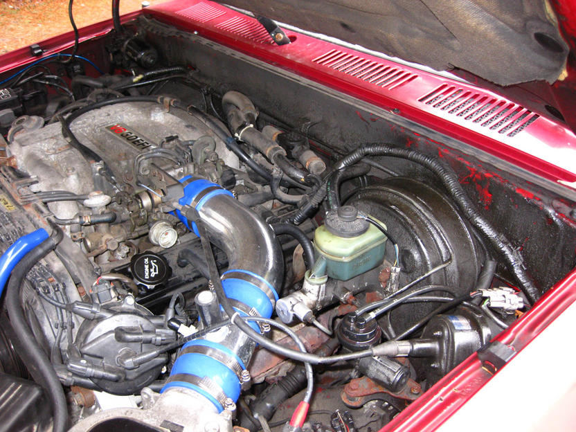

This is mine...
I bought a kit of e-Bay for $60, modified it a little..
The center section with the 2 nipples should be blocked off (I plan on putting a new tube in place without the nipples), the kit has them routed to the breather tubes on top of the timing belt cover, basically a huge vac leak! I also opted to not use the Cone Filter...
I used my stock air box with a K&N factory replacement filter, its also a lot quieter vs. the cone!!!... Works very well!
