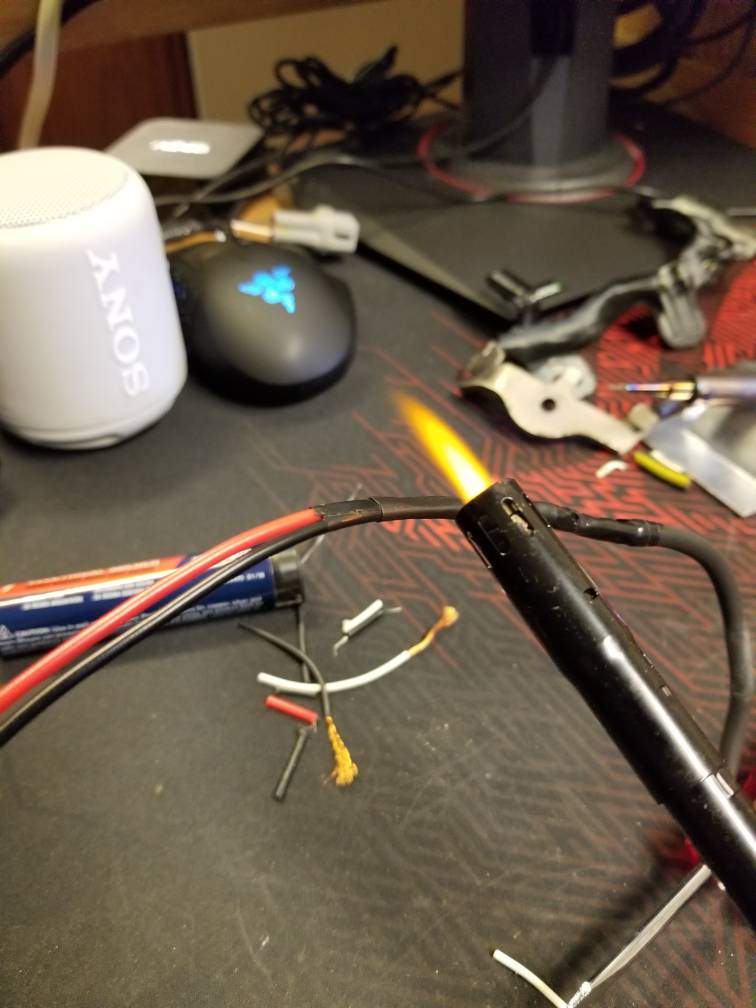

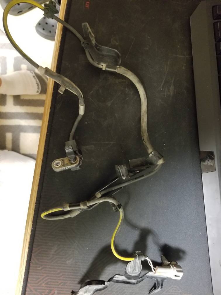

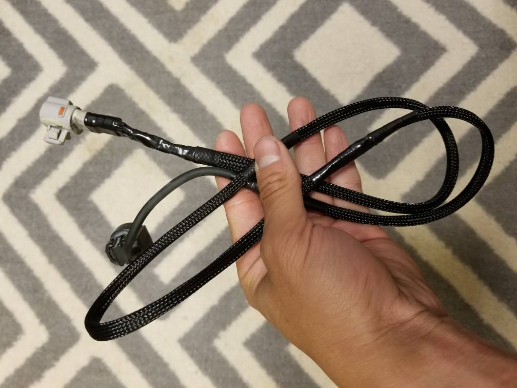

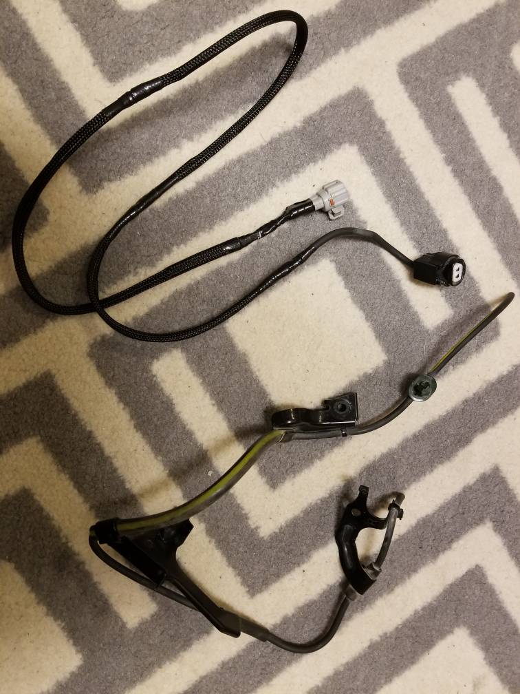

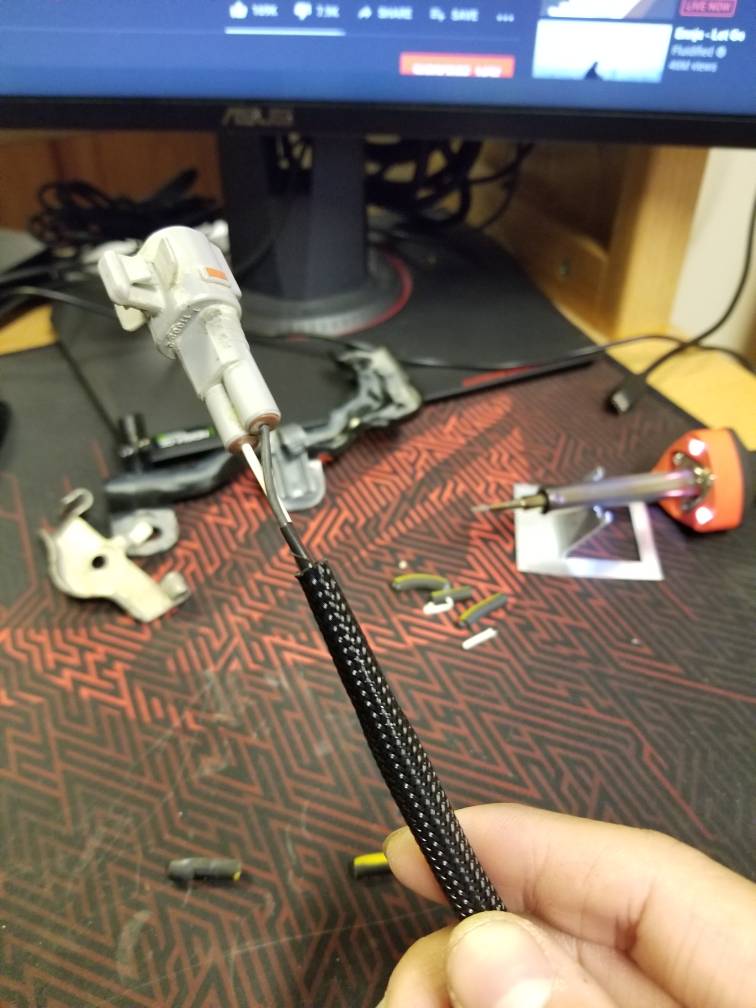

Ok just to update it is fixed! Went to toyota this morning for my alignment and they offered me $200 to replace and install the harness. The harness and sensor is separate, the harness costed $85. So I went ahead and told then I'll just purchase the harness for $85 and install on my own, but it comes Tuesday next week. Driving home I said f@#! It and when I got home, I cut both ends, soldered to new wires along with waterproofing and covering them up with a strong plastic sheath. Prayed then went to install it. IT WORKED! no lights, nothing! Took literally less than 2hrs including putting it back in and reusing the brackets. Went back to toyota because my alignment was off and asked if I could cancel the order... they cant...until it arrives here. Whatever, at least I get my $85 back for literally a piece of wire that I made free.[emoji849][emoji57]
