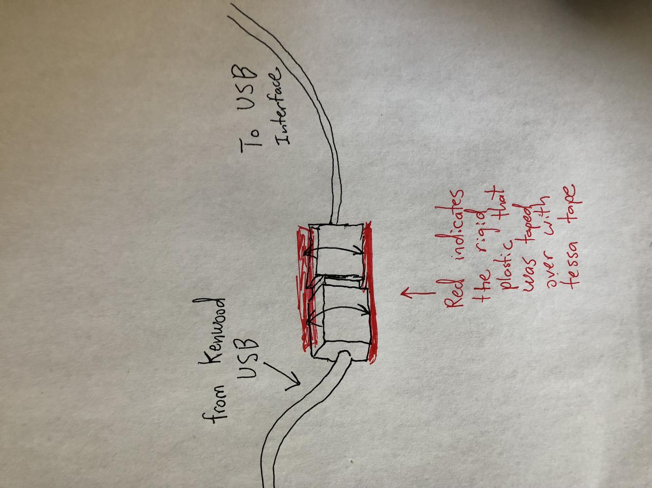

I believe I was able to solve the issue today. My issue originated where the connector from the radio was connected to the usb interface. Any slight movement of the usb caused it to fail. I was able to use some rigid plastic cut to the length of both usbs for each side and then taped over these pieces to form a strong spot. Now neither of them move and my Apple CarPlay has yet to fail

Your radio looks really good! and unfortunately not. I did make a drawing in hopes that it could help you

Thanks Brother! A picture is worth a thousand words. I'll get in there one of these nights this week, and see about fabbing up one of these "Johns06Yota" solutions!
